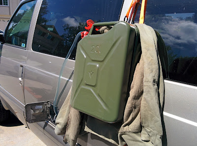

I've been very happy with a $10 Super Siphon and a ratchet strap to hang the can from my roof rack while I transfer the fuel. (And a floormat or jacket between the can and the side of the van)

Have one of those too! Ingenious with the strap and jacket! Gonna use that trixk

My solution to slow-pouring CARB-addled cans would work as well for your narrow flex line trouble with a NATO filler - a SuperSiphon and a length of hose. Get it flowing and I go do something else for a few minutes and I don't have to stand around holding 50# in the air.
