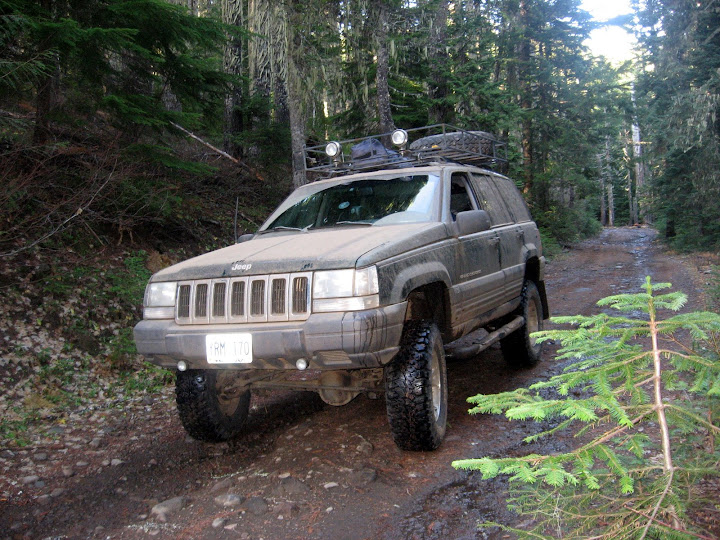

Thought I'd post a couple pics of my 96 ZJ. There are some incredible vehicles in this forum.

I agree, those nerf bars will cause more damage than they will protect you from if you snag a rock or tree stump with them. You need a pair of rock rails that will support the weight of the vehicle instead. First investment I made & I have used them often.

It's funny how usual "off road packages" just contain useless crap that you take off. Brush guards, light guards, side steps.... all companies are guilty.

I'm sure you're right. I put them on a couple months ago as they were more easily available than true rock rails. 2 days after installation I bent the passenger side by bashing it off a rock multiple times. At least it kept the jeep from getting too trashed. Rails are on the list.
What do you think about front bumpers? I'm debating between having a bumper built with a winch mount or having a front receiver installed and mounting a winch that way. Any thoughts???

Nice Jeep, looks like a great platform to build from.
I think that the general concensus on winches in receivers is that the are great in theory, but the likely hood of getting hung somewhere where you can't get the winch into the receiver would outway the benefits of having a portable winch mount. The receivers often leave the winch several inches low, killing departure angle in that sort of a setup.... great in theory, not very practical in application. It's a shame though, that was the route I wanted to go too.
