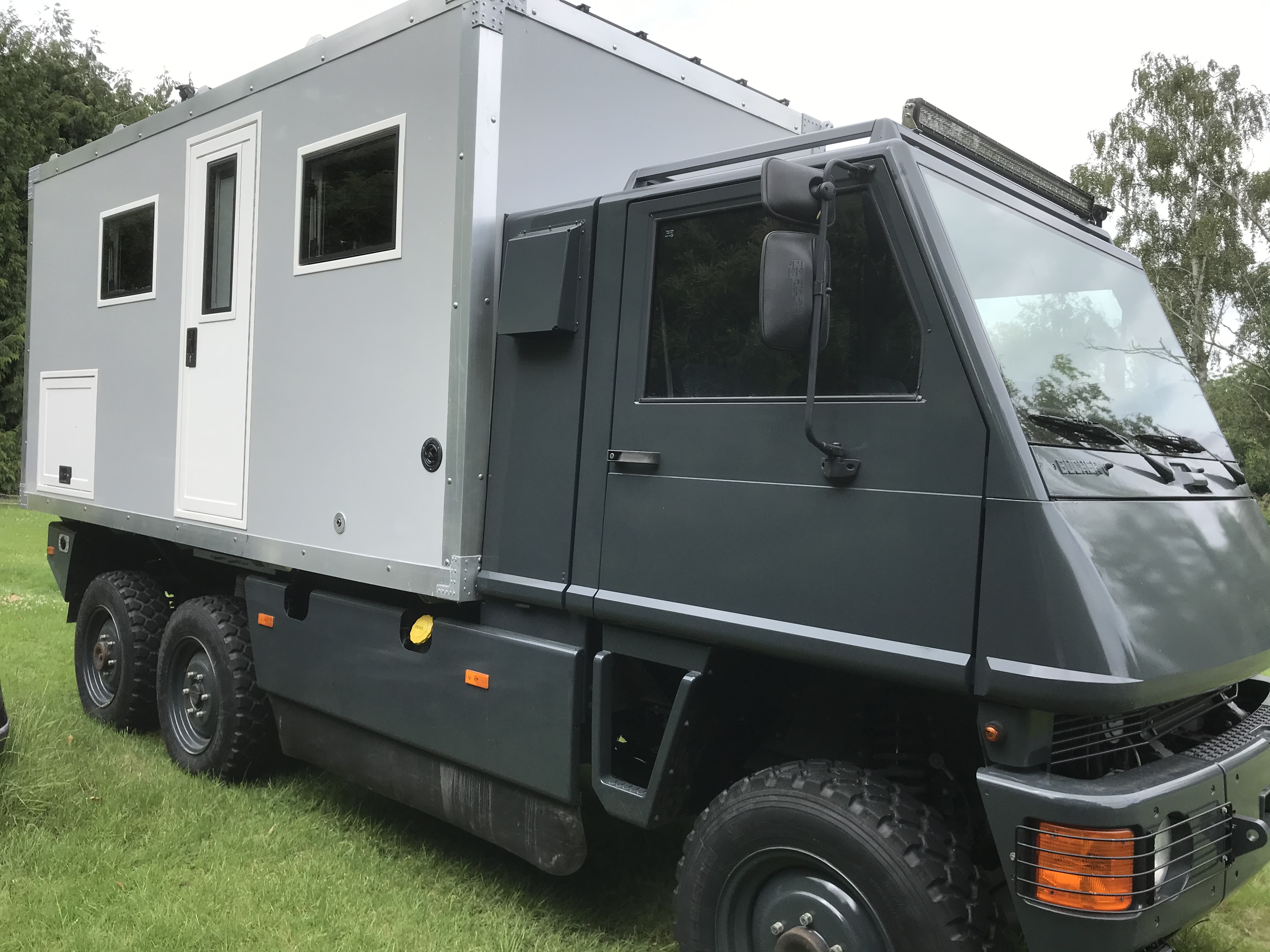

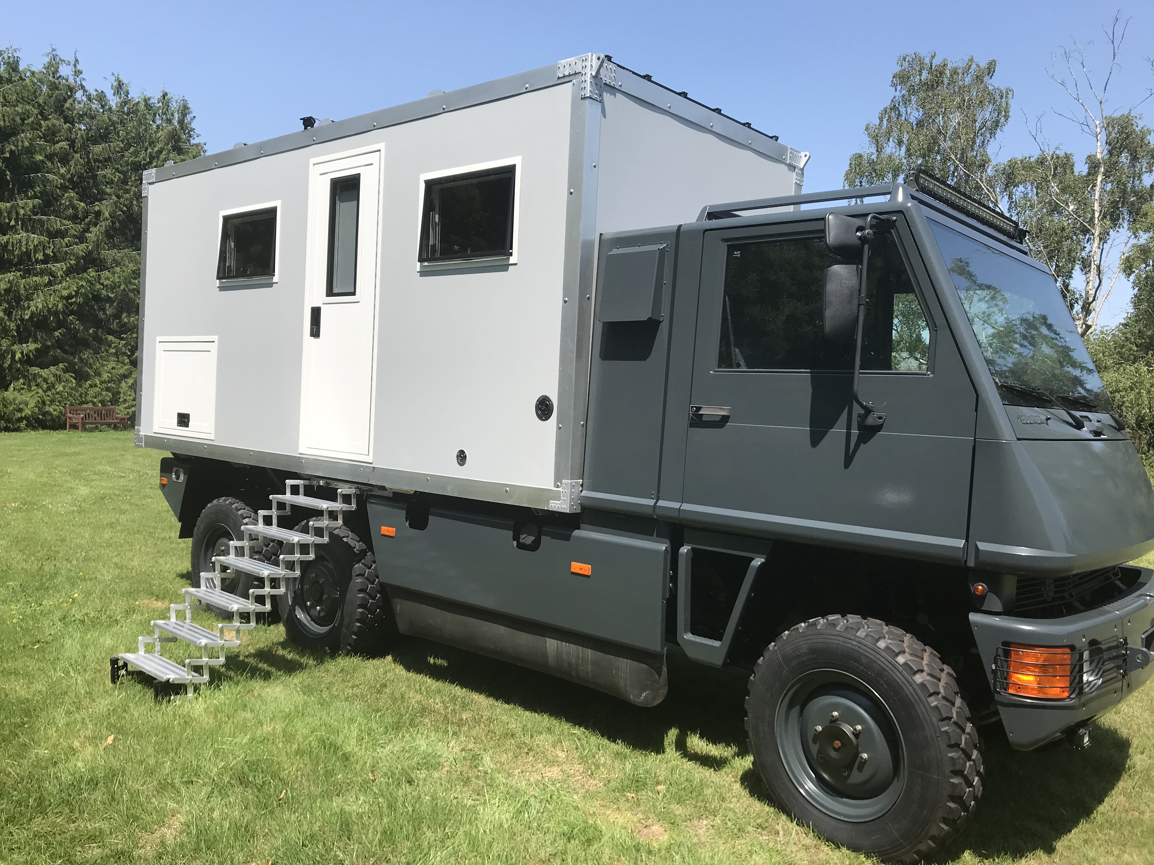

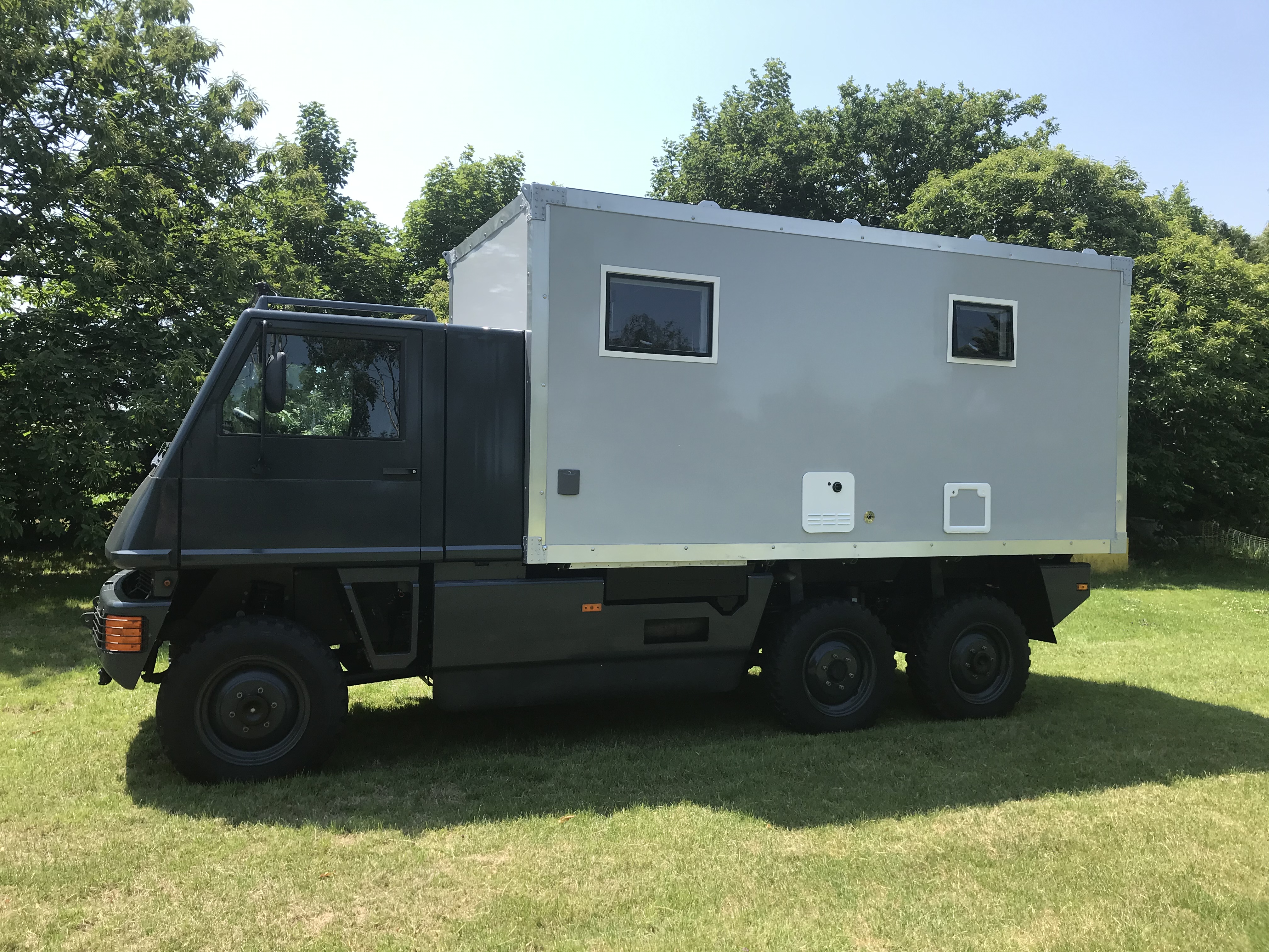

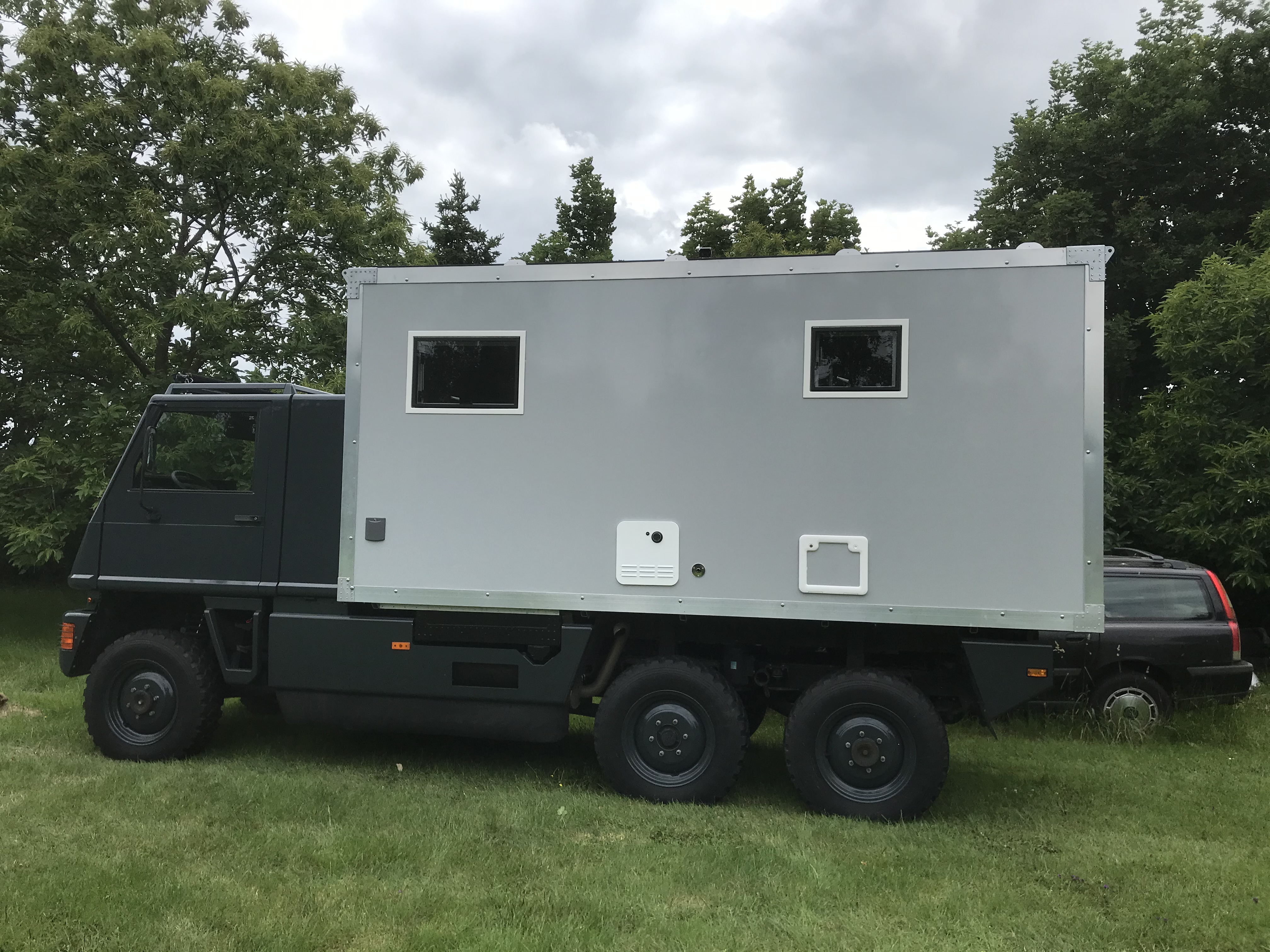

Travel gypsy
Box. 50mm sandwich board
Windows. Outbound double glazed toughened glass
All widows have blackout blinds and mosquito screen
Roof. 4x1215 watt solar panels.
Cameras to sides front and rear
1500mm x400mm aluminium roof box for storage
52inch light bar on cab roof
2x fog lights.
Under the internal floor.
2x lpg gas tanks , with filler to the offside of the box to the rear.
4.5 bar water pump
Whale gulper for the shower outlet.
4x 250ah gel batteries
3 x 60ltr water tanks plus 1 x 100 let water under the seating area
100ltr grey water tank
80 diesel tank for heating
2x 8kw diesel heaters
Safe

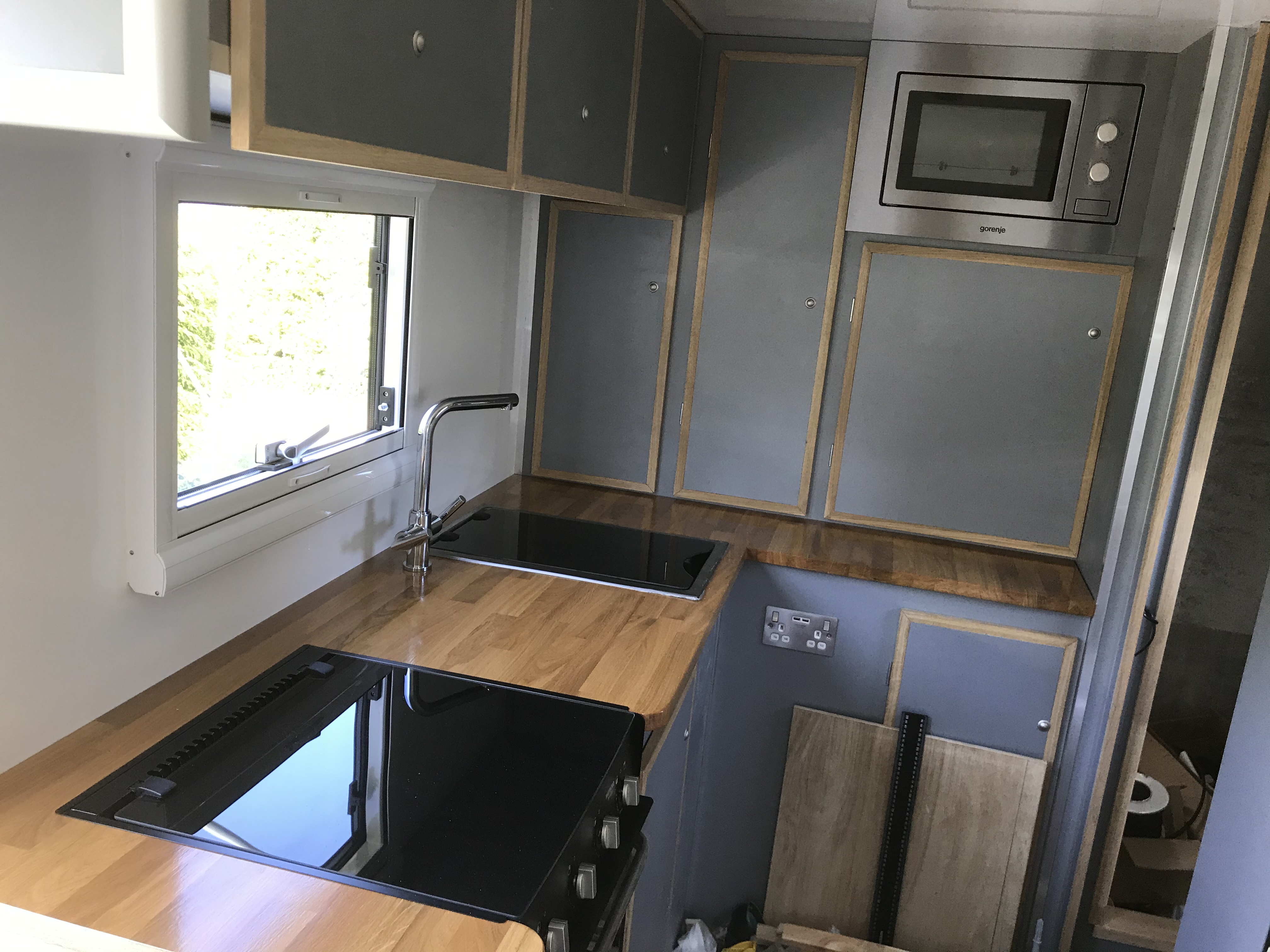

Imass water heater. Shower and sink
Candy 4kilo washing machine
800watt microwave
Thetford 3 burner hob / oven and grill
Thetford cassette toilet
Shower with mixer tap ( water to grey water tank with gulper pump).
Kitchen sink with mixer tap ( water to grey water tank)

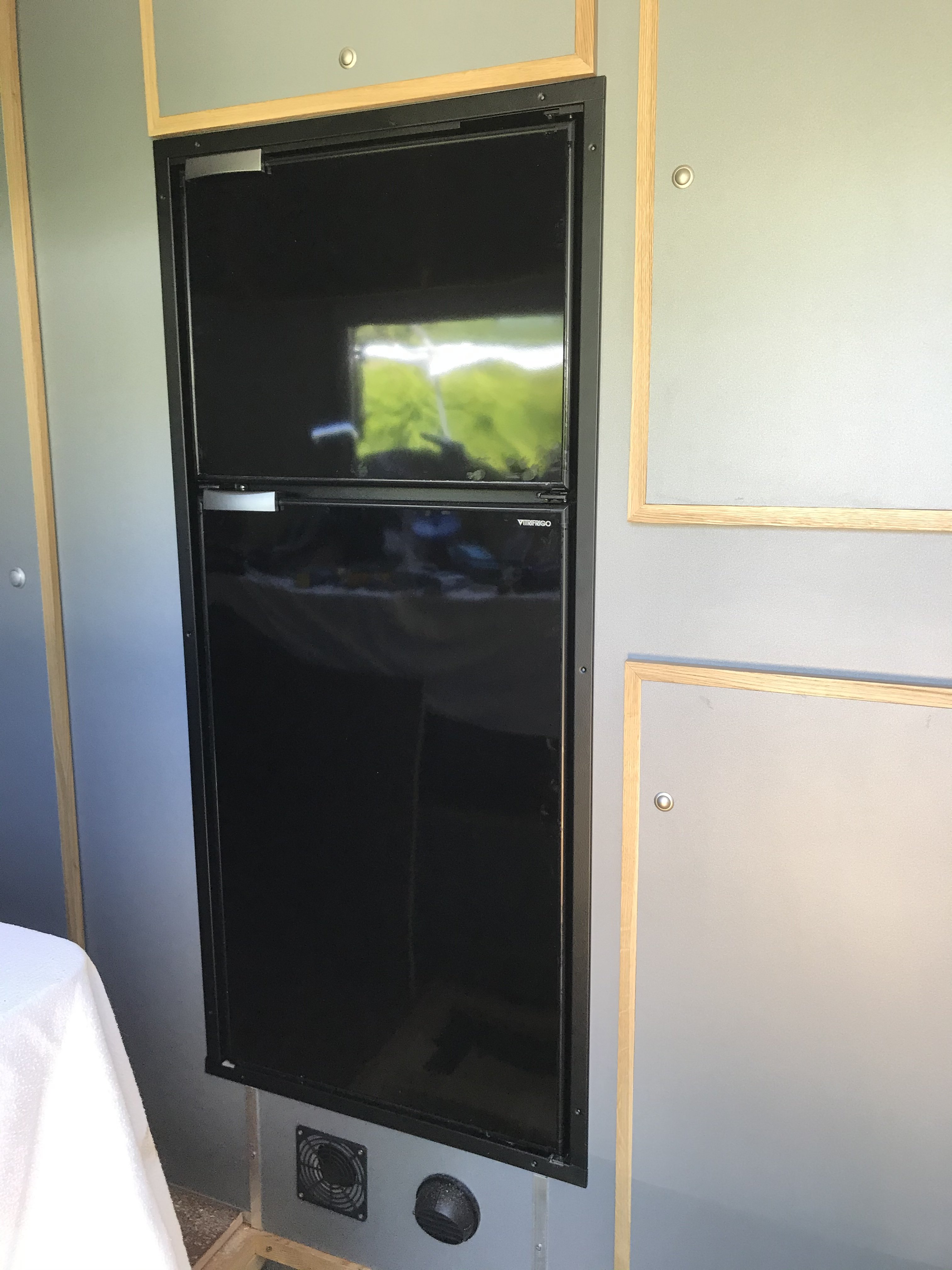

Vitrifrigo fridge freezer 70ltr/145ltr.

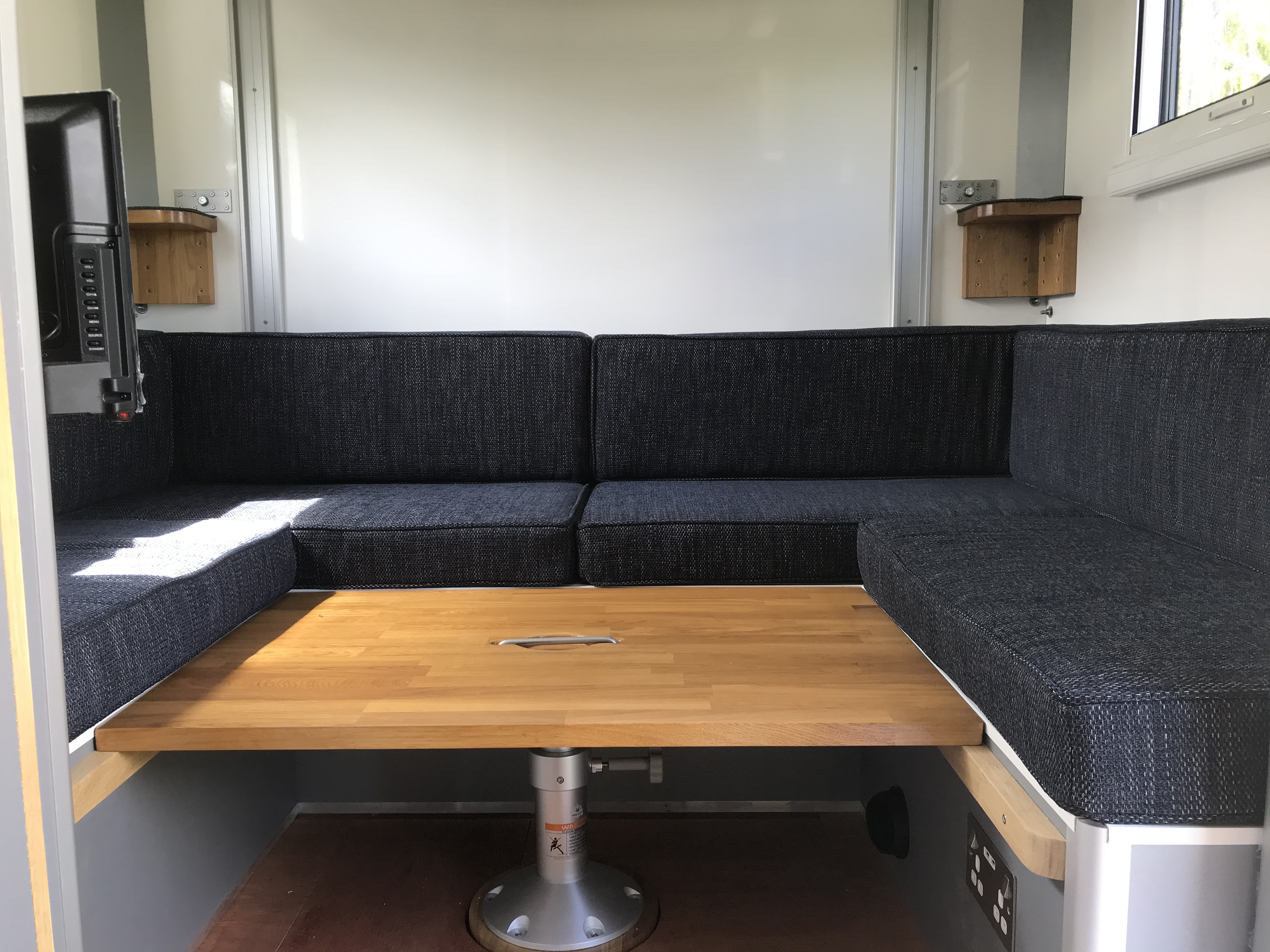

Solid Oak worktop and table top
Cello 12volt tv
3.8kw generator. For charging when totally off grid . Also to run the microwave and washing machine.
Drop down electric bed over the seating area with table on a telescopic leg to all seating area to become another double sleeping area.
LED lighting inside. Plus external light near the steps
Sterling Power 60amp charger ( gen set or shore power).
Mppt charge controller for the solar (SmartSolar). VictronConnect.
Cab. All the floor has been sound proofed with high density foam and carpet
Seats reupholstered ( rather than the military plastic seats)
10 inch screen for cameras around the truck.
This truck is in England. Left hand drive. Class 4 mot. Fully registered as a motor home
