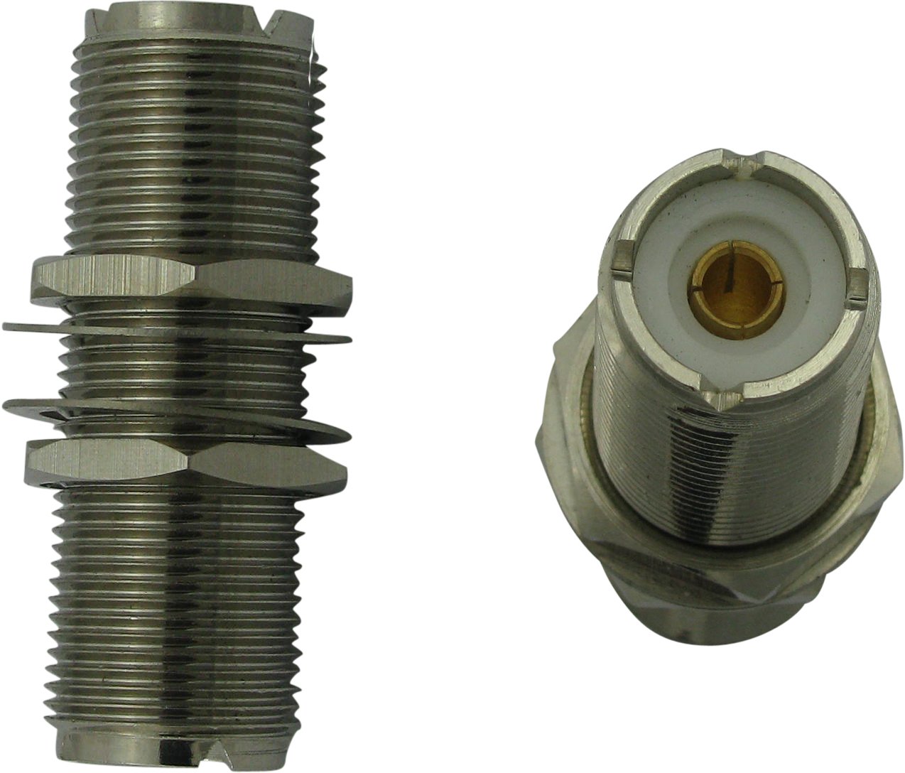

I'm having some problems getting my 2M/70CM antenna mounted on my jeep. I installed the Teraflex Antenna Mount that installs behind the tail light but I have noticed that all the connectors that join the PL239 to the antenna seem to have a PL239 connector on one side and a stud mount on the other. I need something with a male PL239 on both sides that will go through an antenna mount. I also have the Firestik MJK4R and it's similar. The antenna mount is for a stud.
My antenna is a Diamond that has a female PL239 connector at it's base.
How do I go about getting the antenna installed on my Jeep?

Search on "pl-259 bulkhead connector". Install bulkhead connector in bracket, coax screws on bottom, antenna screws on top.
Have fun,
The aforementioned bulkhead adapter is the way to go.

I couldn't get the MFJ Antenna to work so I got a bulkhead connector and drilled out the hole on the Teraflex Antenna Mount and installed the antenna. SWR is great now.
Thanks for all the help.
