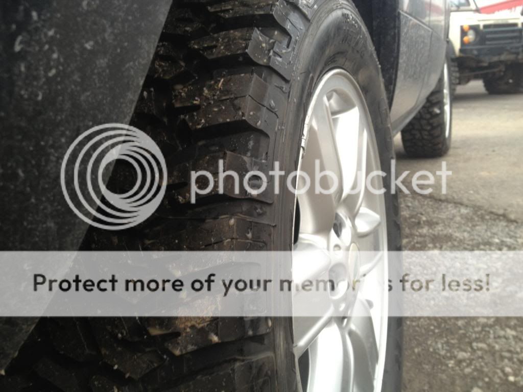

To get things started the truck needed some better shoes.
We went with the stock size 19s in a MTR. This was not our first choice but the tires were the right price. " Free"
With the truck in its stock form the tires look a little out of place but that did not stop us from an icy test drive.

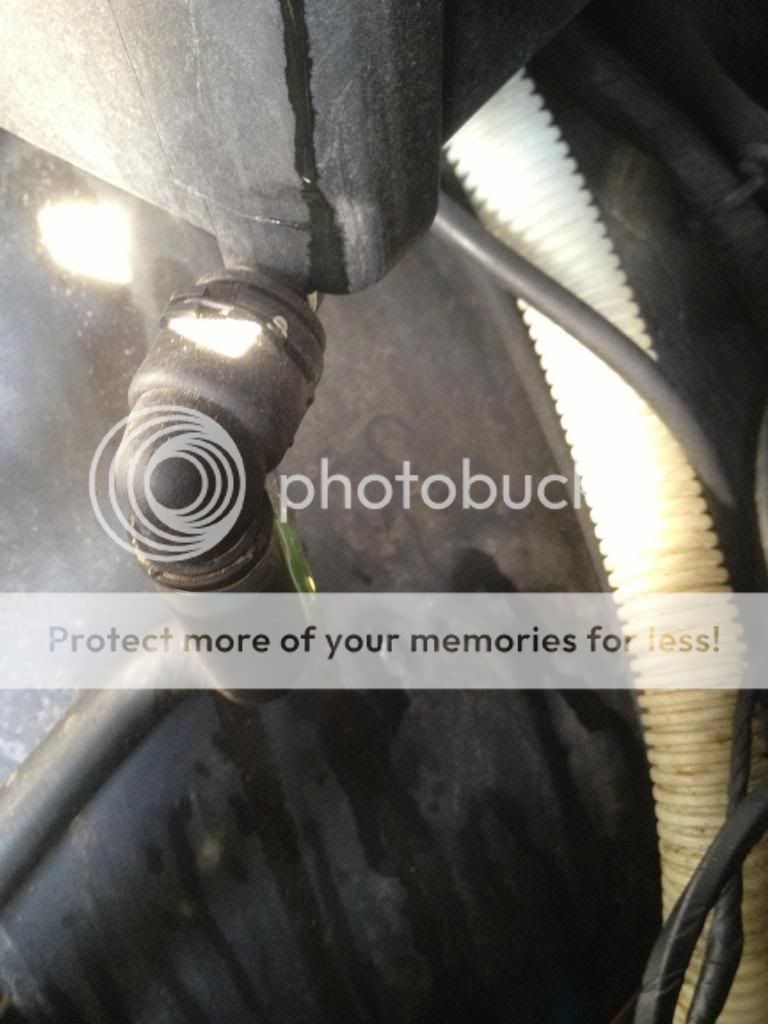

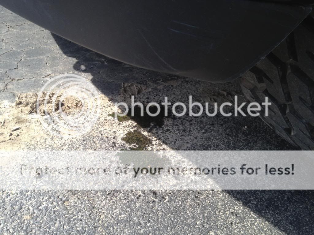

The L322 wanted us to feel comfortable with it so it gave us a little present.
It wouldn't be a rover without a little leak. The expansion tank has a small crack in it. This is a fairly common thing with these trucks.
We will get that fixed and report back.
