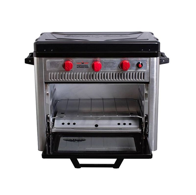

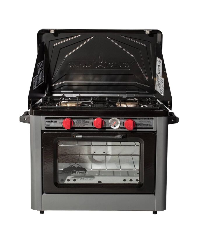

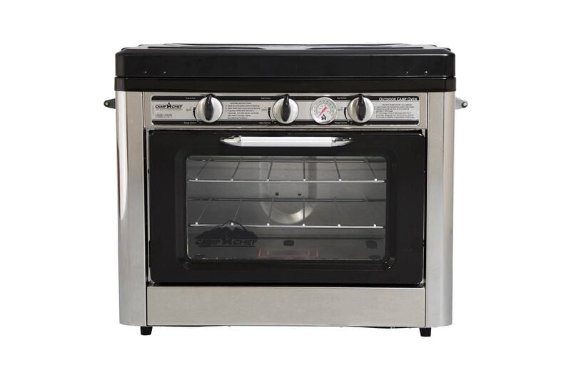

Camp Chef outdoor ovens:

And want something installed inside, but will research the campchef items and see if any could go inside. Thanks for this lead.

Just cover the Camp Chef in asbestos? :unsure: ... :cool: ... Okay, it might be better to use a different insulation. :) ... Maybe ceramic insulation blankets for wood stoves? Maybe mounted to slide out for use?
