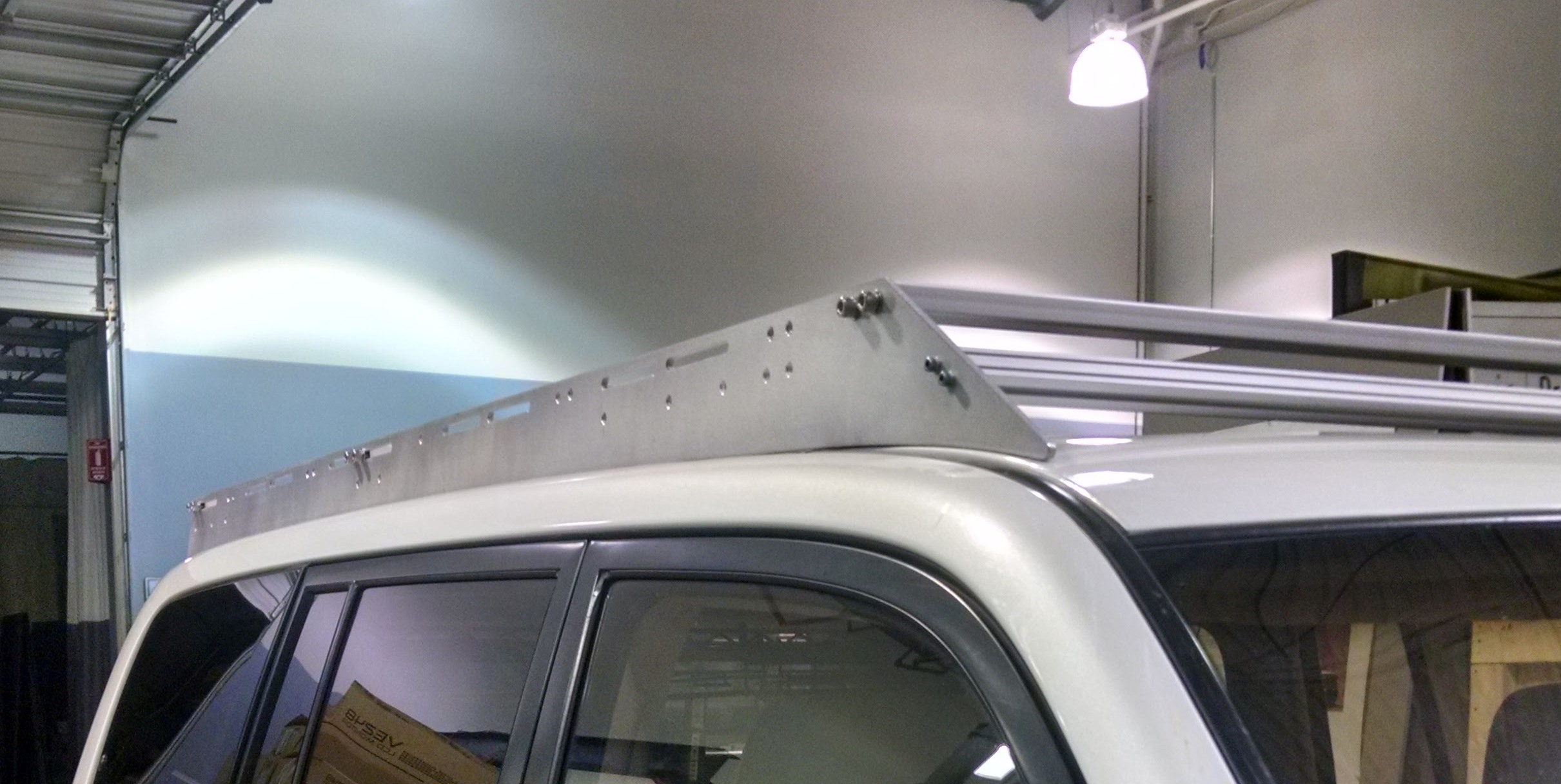

I've decided to sell my roof rack project for pennies on the dollar. With an expanding family I really have no time to devote to this in the next couple of years.
I designed the side pieces and had them waterjetted out of 1/4" thick 6061-T6 aluminum. This material is nearly 3 times stronger than mild steel for the same weight.
It is designed to hold up to 11 cross-bars made of aluminum extrusions (80/20 or similar brand). Everything is metric just like the vehicle itself.
Air-Dam support is made out of https://8020.net/20-2040.html Main extrusions are made out of https://8020.net/shop/40-4020.html
Weights are as follows:
Side Pieces - 12.5lbs - Both sides are included.
Air Dam Support- 2lbs - 1 is included. You need only one.
Main Extrusion (per piece) - 3.3lbs - 3 are included, can fit up to 11.
Stainless Hardware (estimate) - 2lbs - You'll need to buy more and I can provide part#s.
Mounts - You need to figure this out. I would avoid welding to the side pieces.
Air-Dam - You need to figure this out. I planned to make one out of 1/4" thick HDPE.
You could have a working roof rack that's strong and functional for as low as 35lbs of weight on your roof, and less than a quarter of the price of Front Runner or similar ones.
$150 firm + actual shipping cost.
Shipping could be anywhere from $75 to $100 $55-$60 based on an quick quote from Fedex UPS, but send me your address for actual quote.
HDPE air-dam not included.

$55.70 to your zip code, UPS ground. Total length is just under 87". I designed the rails to sit as close as possible to the roof, but you still mount the first and last one vertical for maximum bending strength.

More engg info for those who care:
Here are some dimensions of the side plates:
Loading platform length (flat side) = 77"
Roof side length (curved side) = 87"
Overall Height (top to bottom surfaces) = 3.5"
Air-Dam angle from vertical = 57 degrees (matches windshield angle somewhat in side view)
Thickness = 1/4"
Up to 16 cross rails will fit. You could cram more but I don't see the point.
Here is the cross-rail profile, beefy but still light.
According to the manufacturer's deflection calculator, this profile with a 4-foot length will bend just a little over 1/4" when you place a 200lb load concentrated at its center. That's pretty strong!
