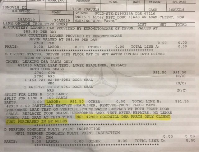

Sent the truck to the dealer and after about a week's worth of testing they've come to the conclusion that it's a bad driver's side door seal and it's going to cost ardund $1,000 after whatever discounts they can get together. They said it's not covered under the CPO warranty.
Door Seals go bad after 4 years? Price seems steep but they said the parts are expensive and shipped from the motherland.
Thoughts ?

They already had the truck so too late for that now. last time i pulled out from their service with my sprinter they hit me with a charge for diagnosing etc so i just let them fix it.
just got the truck back. $1,050.99 total. they said they didnt charge for the parts, just for the labor since we just got the truck back in January and the work wasnt covered under the CPO warranty. whatever... its fixed (i hope)
Metric
Well I suppose one way of looking at it is that your total cost is equivalent to the retail cost of 2 seals plus 2 hours of shop time.
