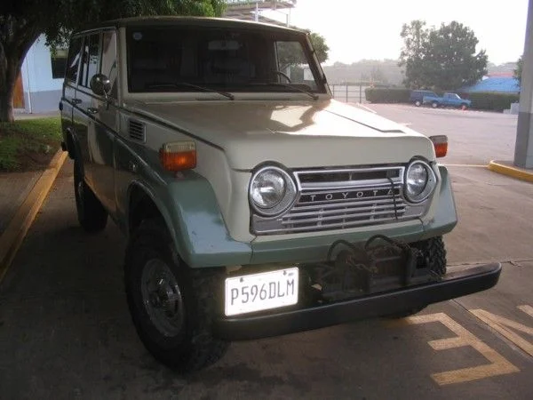

Lucy FJ55
It seems like most of the differences have been posted already. I'll just add my own two cents...
I'm obviously biased, so naturally I love the 55 series. I say drive a few different rigs and buy the one that SPEAKS to you. The 55's did come with power steering and AC from the factory as an option in '78-'80, I believe, but they are rare.
Most of the mechanicals are easily swapable, so don't let that stop you. That's the fun part. Of course, most folks have a budget and I agree that it would be easier and cheaper to start with a 60 series. The 60's definitely have some advantages when compared to the 55. I also agree, when looking for a 55, a clean body is most critical, unless that does not matter to you or apply to your application...
Parts and aftermarket support is fairly rare for the 55, but you can typically buy/get/modify most parts, and the internet makes that so much easier than in years past. Yes, both 60's and 55's have leaf springs, under the axle, on all four corners. Simiar setup for both.
And of course, the're just soooo cool. :bowdown:
