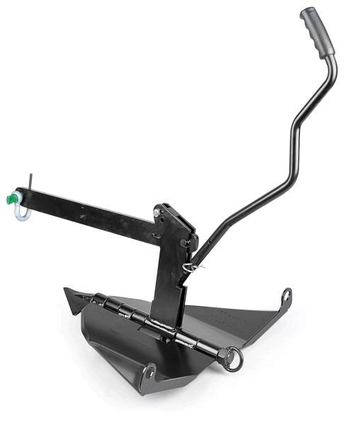

I did a lot of desert exploring in AZ in college and a friend of mine had one of these.
He swears by it. I have never personally used it and I believe it is bulky and heavy but apparently it works well.
