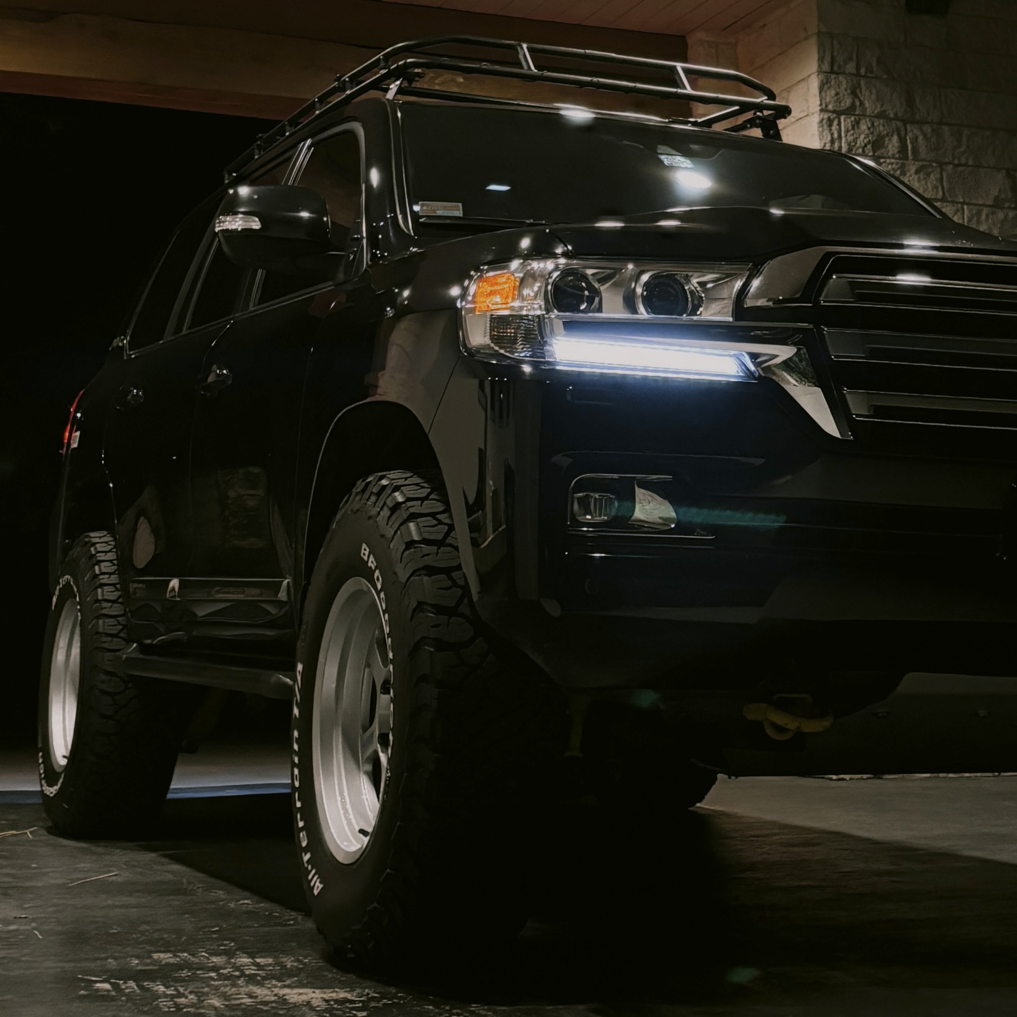

Hi all, been lurking here for a while and spending most of my time on IH8MUD, thought I should join this community as well (intro+build thread!). You can find more pictures on my Instagram page @twundy.
Here's how my Land Cruiser, "Oso", is currently:
2016 Land Cruiser 200 Series (Two-Hundy = Twundy ;))
-Black Exterior
-Terra Interior
Current Mod List (Phase 1):
-Method 314 17x8.5+0
-General Grabber ATX LT285/70R17 (~33")
-Toyota OEM Front Coil Spacer Lift (=20mm/~0.79") for Leveling, stock suspension otherwise
-Gobi Stealth Roof Rack
-Gobi Ladder
-Powder coated HD Recovery Points
-Husky Weatherbeater Floor Liners
-Small cosmetic mods (Auxito LED's, magnetic mount, stainless steel shift knob, etc.)
The next phase of mods should be a 2-3" lift, 34-35's, lighting, etc.
