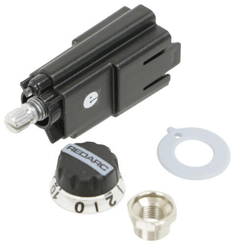

Hi All,
I’ve wired in a REDARC Tow-Pro Elite trailer brake Controller into my 2014 Jeep JKU with the max tow package.
Lights work. Bake lights illuminate. Turn signals work. I assume all of these are working due to the stock four pin connection into the seven pin harness.
The blue light on the control knob light “breathes” blue when I depress the knob. All that said, the brakes are not engaging. I’ve gone through all the wiring and believe it’s all correct. The red wire from the brake controller is connected to the brake light trigger wire in the brake wiring loom just above brake pedal. It’s the white wire with tan stripe per various videos on YouTube. All instructions indicate that the wire should only carry a signal only when the brake pedal is depressed. Here’s the catch, it’s “hot” all the time. So are all the other “hot” wires in this loom. So as a result I’m not getting any actual braking power to the trailer.
I’m stumped. Any advice on what to check or where else to connect the red brake controller wire would be appreciated. I need to tow at 2500lb trailer through the mountains of WV this coming weekend. All paved roads.
Thanks!

Update- turns out the wire I tapped into is one that only goes “hot” when the brakes are applied. There is a small “plunger” switch on the back of the wiring harness that when depressed cuts the power. When released, it allows for constant power to the harness and hence the wire. When the harness is placed back into the mounting position, the plunger is permanently depressed. I assume that power is then only distributed when the pedal is depressed. I haven’t been able to test this yet. Thanks again for all the suggestions to date.
