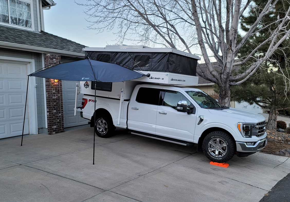

FedEx stopped by while I was installing the battery and dropped off my MoonShade awning. It took about 6 minutes to unbox it and set it up.
I spent a lot of time researching and debating the awning issue. In the end, I just couldn't justify adding 50lbs of weight and another $1000 + dollars for a permanent awning. The MoonShade seems a bit overpriced for what it is, but 8 lbs and the infinite adjustability won me over in the end. It's easily attached to any side of the CAMP-X or my truck, so I expect we'll use it quite a bit.

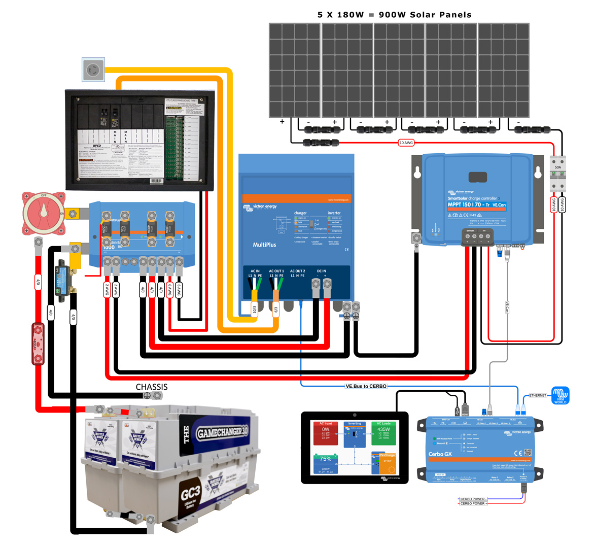

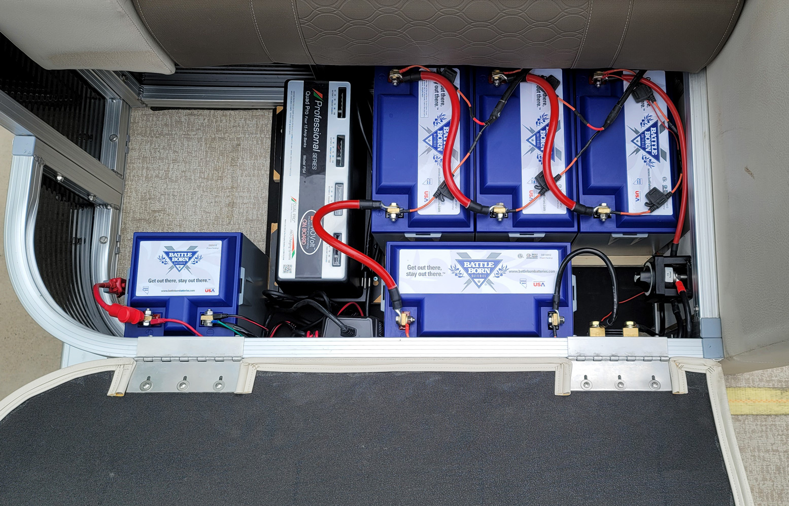

As I mentioned before, I think we're a little overpowered for the average overnight trip, but I don't like "battery anxiety", so it's nice to have. This is the system I installed in our TT camper.
Its got 900 Watts of solar and 540Ah of Battle Born LiFePO4. We hit this pretty hard every day we camp and it usually manages a complete recovery via solar, as long as our campsite doesn't have too much shade. The ratio of solar to battery on my CAMP-X is pretty low, but as you mentioned, the 200 Watt panel should be capable of topping off what we draw for most items. I haven't been able to find a 12v option for the Starlink yet, so I'm curious to see the hit we'll take if we want to run satellite internet all the time from the inverter.
