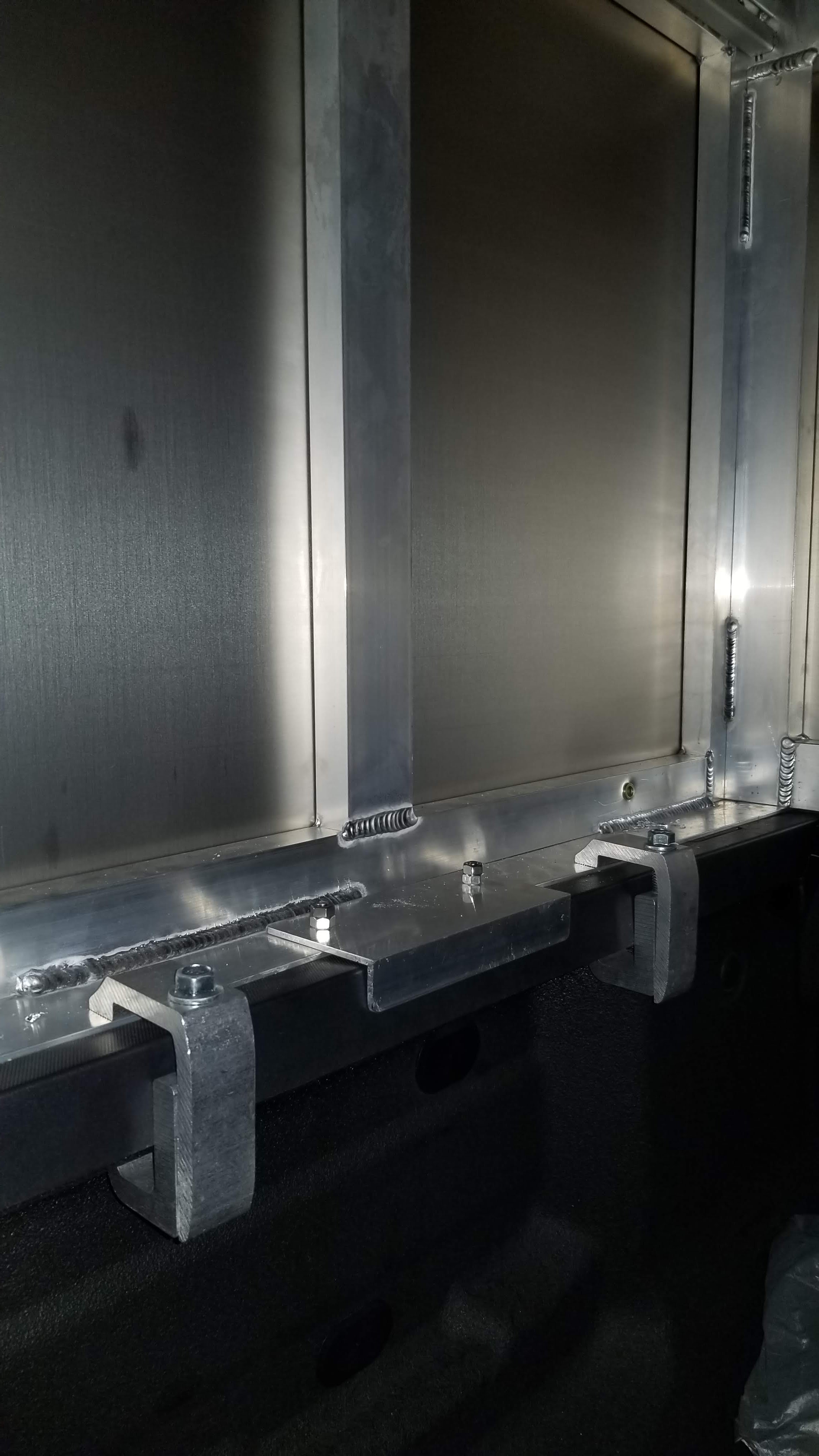

Been a long while since I've posted an update. Added insulation inside, old man emu heavy-duty springs, bug net. And rear seat delete for more storage and a refrigerator.
