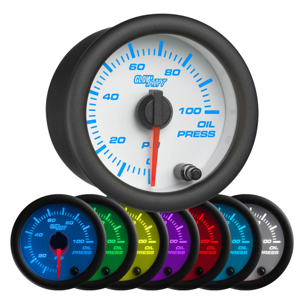

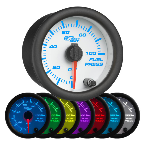

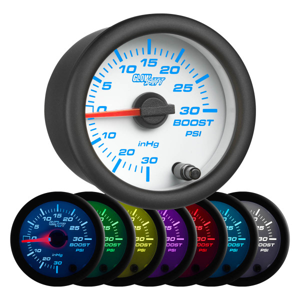

Innovate DLG-1: Dual Lambda (Air/Fuel Ratio) Gauge
Glow shift
1 x White 7 Color 100 PSI Fuel Pressure Gauge
1 x White 7 Color Transmission Temperature Gauge
(7 Color Series Extended Wire Harness: Extended Wire Harness)
1 x White 7 Color Oil Pressure Gauge
1 x White 7 Color Water Temperature Gauge
1 x White 7 Color 30 PSI Boost/Vacuum Gauge
It's going to have the A-pillar pod and dash pod custom dyed to match stock interior
