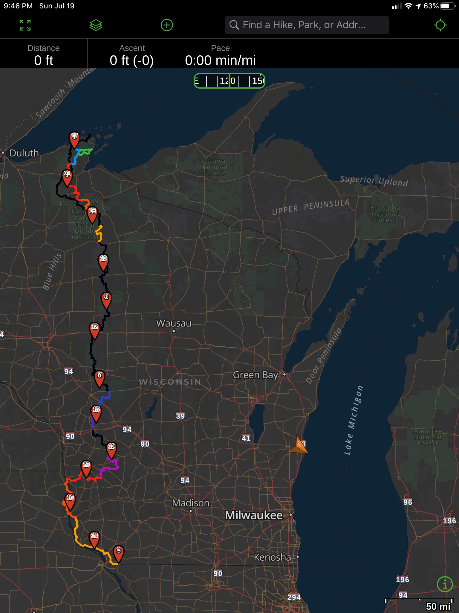

Affectionately called the TWAT, the trans- Wisconsin Adventure Trail starts in South West Wisconsin and heads north through central Wisconsin ending near Copper Harbor. I read a story here on Expo I believe of a guy who added a kayak trip and some mountain biking and it looked like a pretty fun 3-4 day trip.
ionyota
Affectionately called the TWAT, the trans- Wisconsin Adventure Trail starts in South West Wisconsin and heads north through central Wisconsin ending near Copper Harbor. I read a story here on Expo I believe of a guy who added a kayak trip and some mountain biking and it looked like a pretty fun 3-4 day trip.View attachment 600135
?? that map actually ends in Bayfield, however I’d say skip Bayfield and head to Copper Harbor - it’s amazing up there. It’s like a step back in time.
