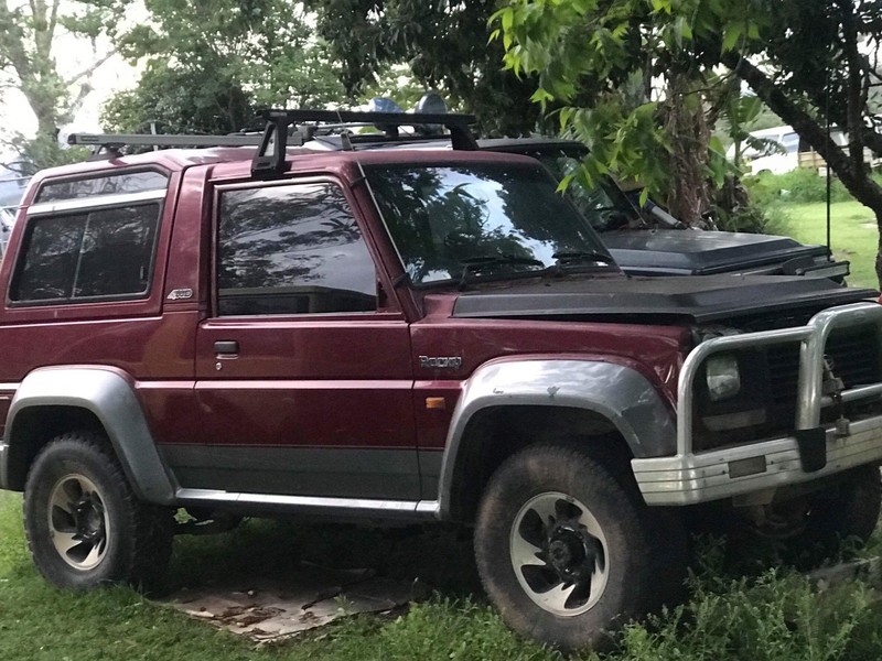

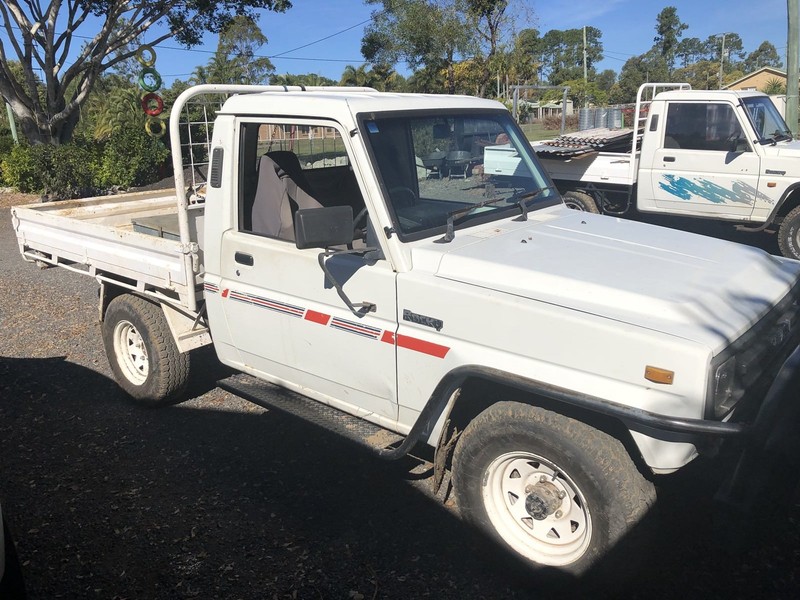

It's interesting that that is a Rocky in the USA - in Australia, it's one of these, where it comes as either a wagon or a ute.
Found a couple of pictures from some for sale ads on Gumtree:
They tend to come with a 2.8 diesel if they're diesel or a 2.0 petrol from Toyota.
polishammer
Yes, it is different here. The one in your picture is a Daihatsu Rugger that was sold in most markets as Rocky. This one was never imported to USA.
American market Rocky was known as Daihatsu Feroza everywhere else.
UK was another country where both of those had yet another names.

Another helpful thing to do is to check for the chassis designation. In America, it's called the Rocky, and elsewhere the Feroza...but the chassis code is F300. In some markets, there was a later update to an F310, but aside from some styling updates, they look very similar. A lot interchanges between the two, but there are differences.
The "Rockys" in other countries are larger for sure, with an ad I saw in the Dominican Republic saying that the one for sale sat 7. I assume in the same configuration as an FJ Troopy, but still.

In the UK the Rugger is a Fourtrak, and most are buggered now - but when they do come up for sale, they're for good money.
Picking up again on the name changes, the Feroza was a Sportrak in the UK.
