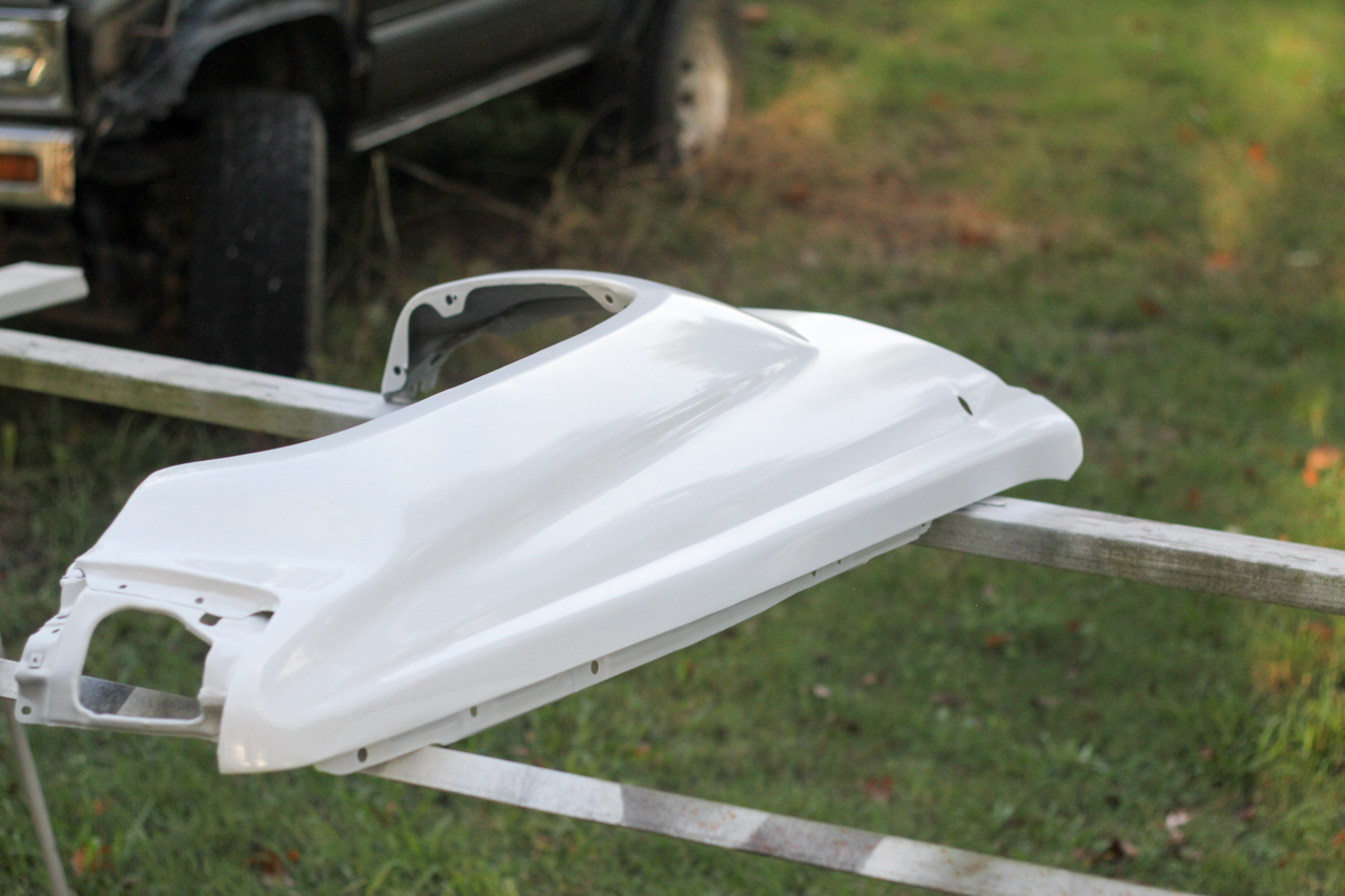

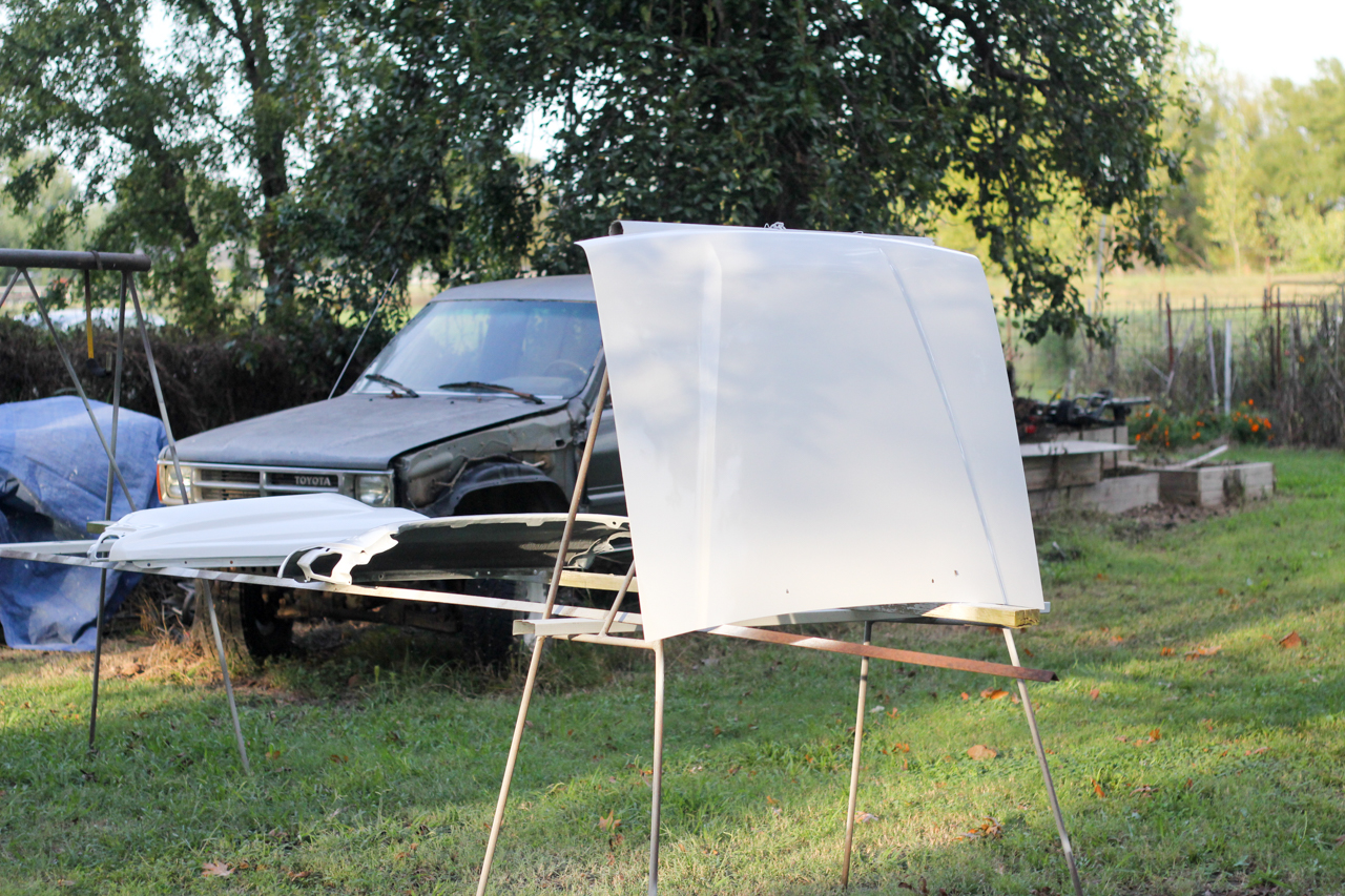

We started on some body work and paint for the 4Runner this week. The plan was to repair and prep the fenders, quarters, hood cowl and hood and get them painted to make sure we liked the color and that our backyard paint booth was going to work. Prep was pretty simple as this won't be a show truck, it will be used and driven through tree trails and have plenty of pinstripes. I understand that there are still small dings that we could have put hours of tedious work into, but that's just not our style of build. Function all the way.
We used a fair amount of filler on the rear quarters and had to weld in some new metal on the fenders. All in all, the body work hasn't been that bad for this old of a rig and considering the treatment from the previous owner, we are lucky that the body wasn't worse.
I didn't get photos of the primer going on a couple of days ago. The weather has been crazy in NE Oklahoma for the past few weeks, so when it isn't raining, you paint.
My Father in Law is the painter, I am the assistant, and my wife is the supervisor.
In this photo you can see one of the spare 1st gens in the yard. It will eventually be a build for my Father in Law, but it needs some work and maybe a swap. Also you can see the roof top tent under the tarp to the left...very soon!
