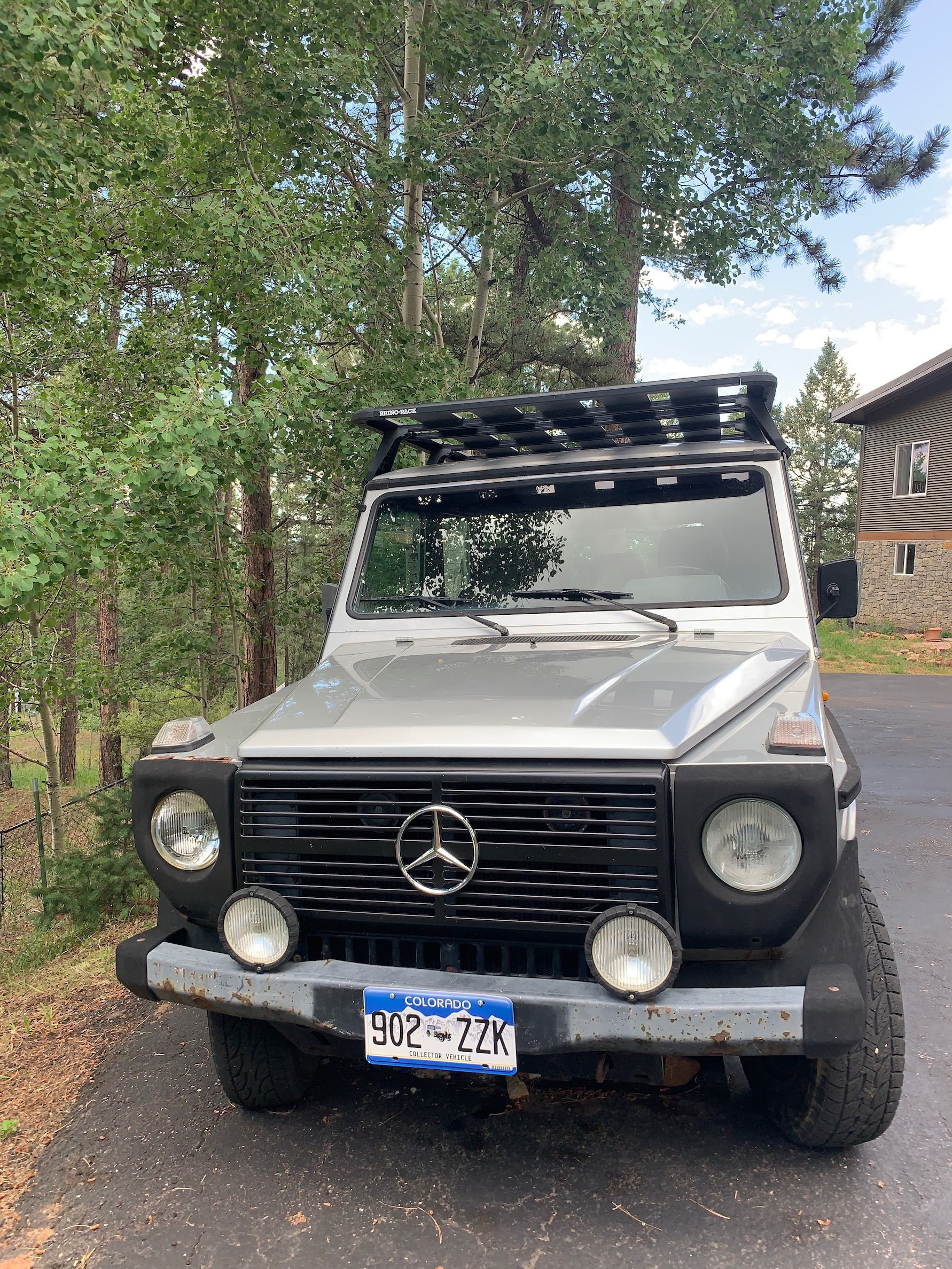

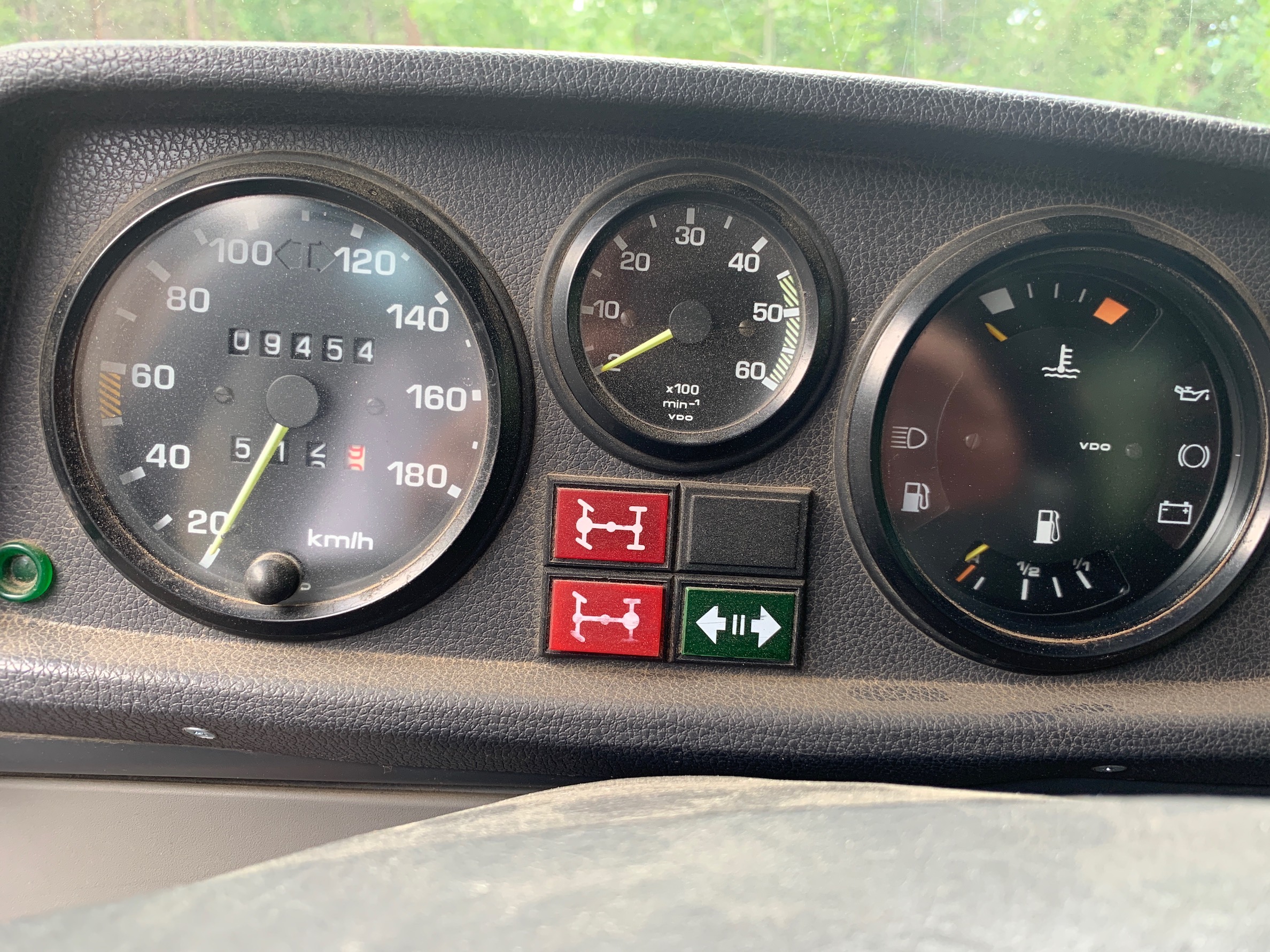

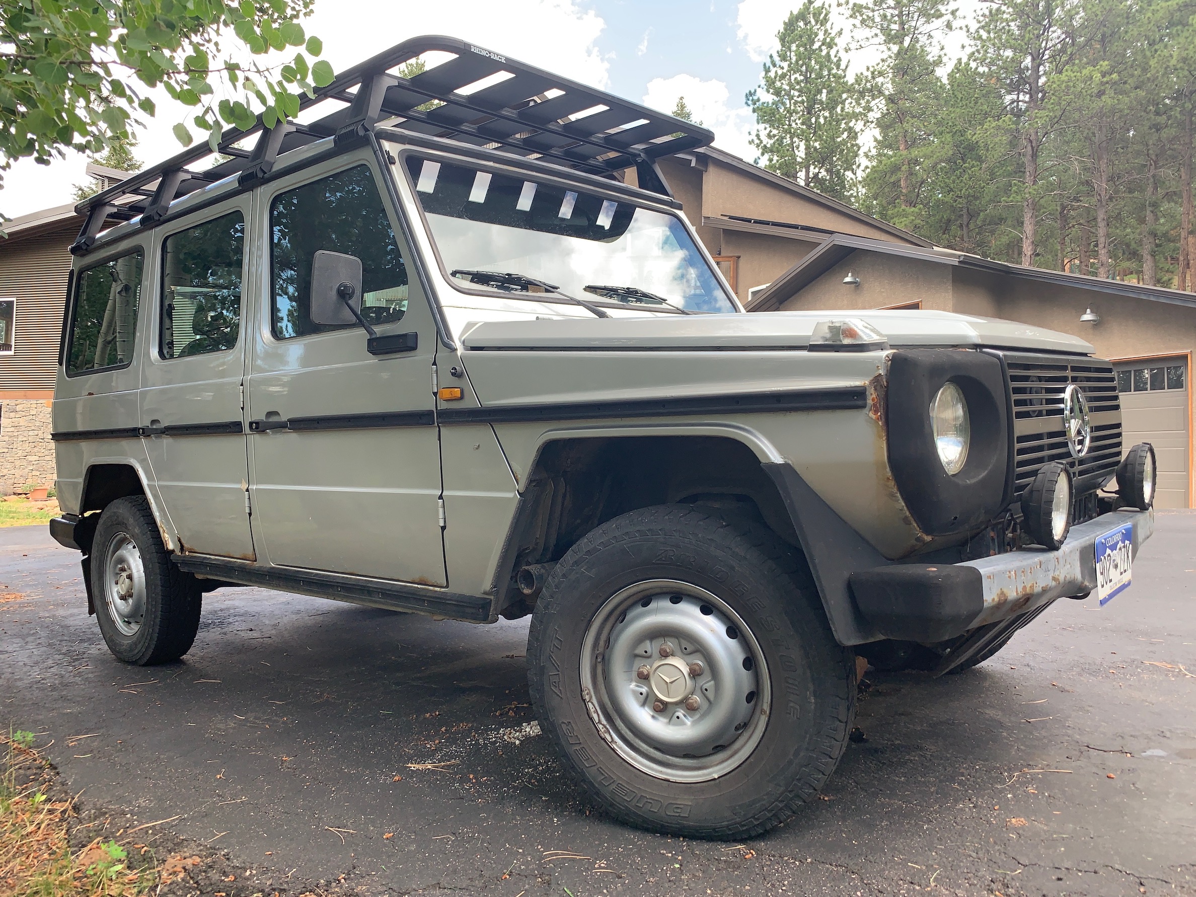

1983 Mercedes 300GD – 109454 km (approximately 68,011 miles). This vehicle is ready to go out and explore.
Engine: OM617 diesel (non-turbo) with power steering
Clear Colorado title in hand.
This Mercedes G-Wagen handles well on and off the road!
The good:
Over the past couple years, I have done a fair amount of maintenance to include:
- New radiator
- New fuel injectors
- New master brake cylinder
- New turn signals on front wings
- Valve adjustment
- New rubber brake lines on the front (4x total)
- New OEM steering damper
- Starts right away, hot or cold and runs very smoothly
- Like new Rhino Rack
- New shifting bushing kit
- New differential covers and gaskets
- New Differential drain plugs
- New V-belt
- New grill emblem
The bad:

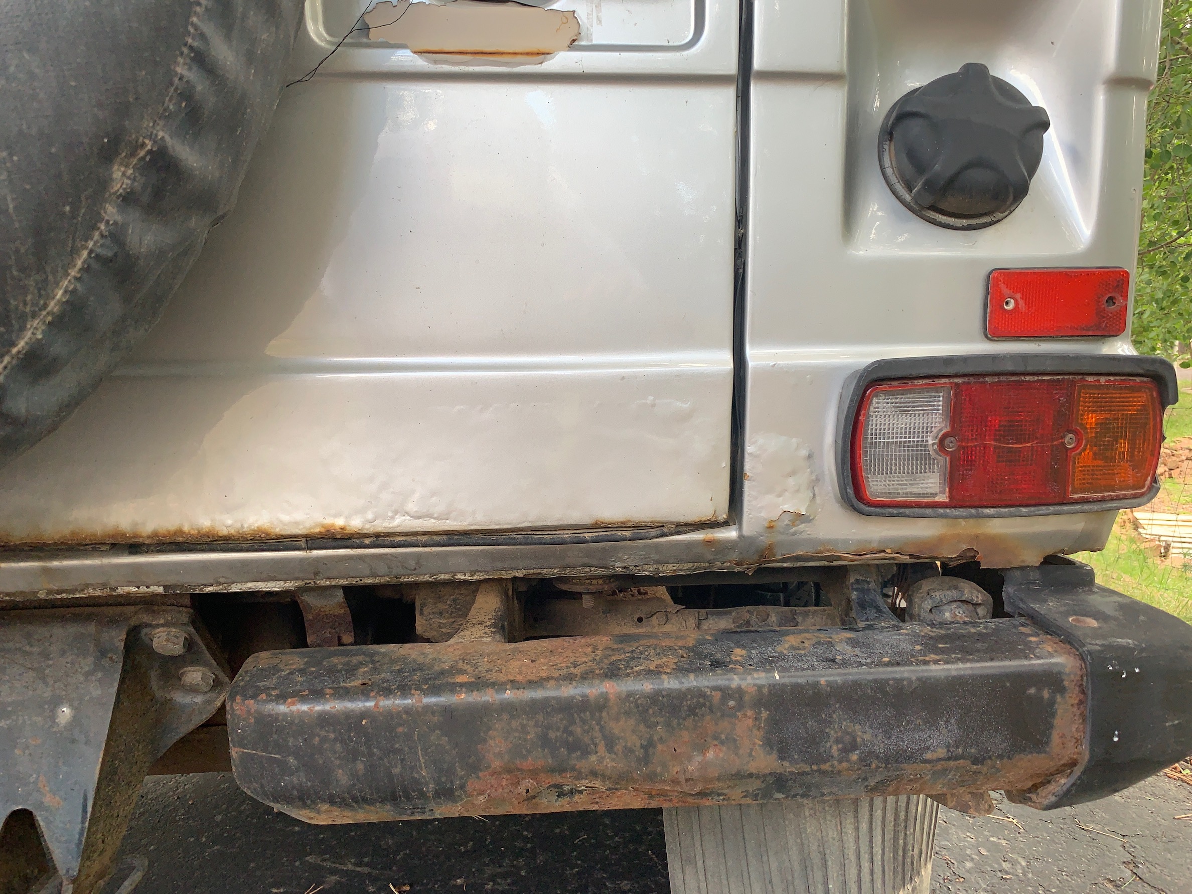

The vehicle is clean and solid but has some rust around the body (see photos). Paint is all original and in very good original condition, some patina on the roof, and some paint chipping off due to body rust. Doors are solid with all functioning locks, windows, and latches with minor rust along the bottoms. Rear bumper could use a replacement. Fuel tank leaks when full which I believe is due to an old gasket on the top of the tank but haven’t been able to diagnose that further yet.
Asking $12,500. I’m happy to take photos of any other aspect of the vehicle if requested.

The rust repair is where you will spend time and money. There's no way around it, other than new panels, which are available from a few USA based sources.

I'm sorry to say that this truck does not have A/C. This is indeed a four speed manual. Unfortunately, the diff locks have seized, I believe it's a linkage issue but I haven't investigated further. The mechanic that maintained the diffs said that everything inside appeared to be in good condition.

The lockers are generally an easy fix. It's most likely the slave cylinders corroding from not being used. It's best to engage lockers once a month to keep them "lubed". The system is very simple and is exactly like your average clutch hydraulic system.
