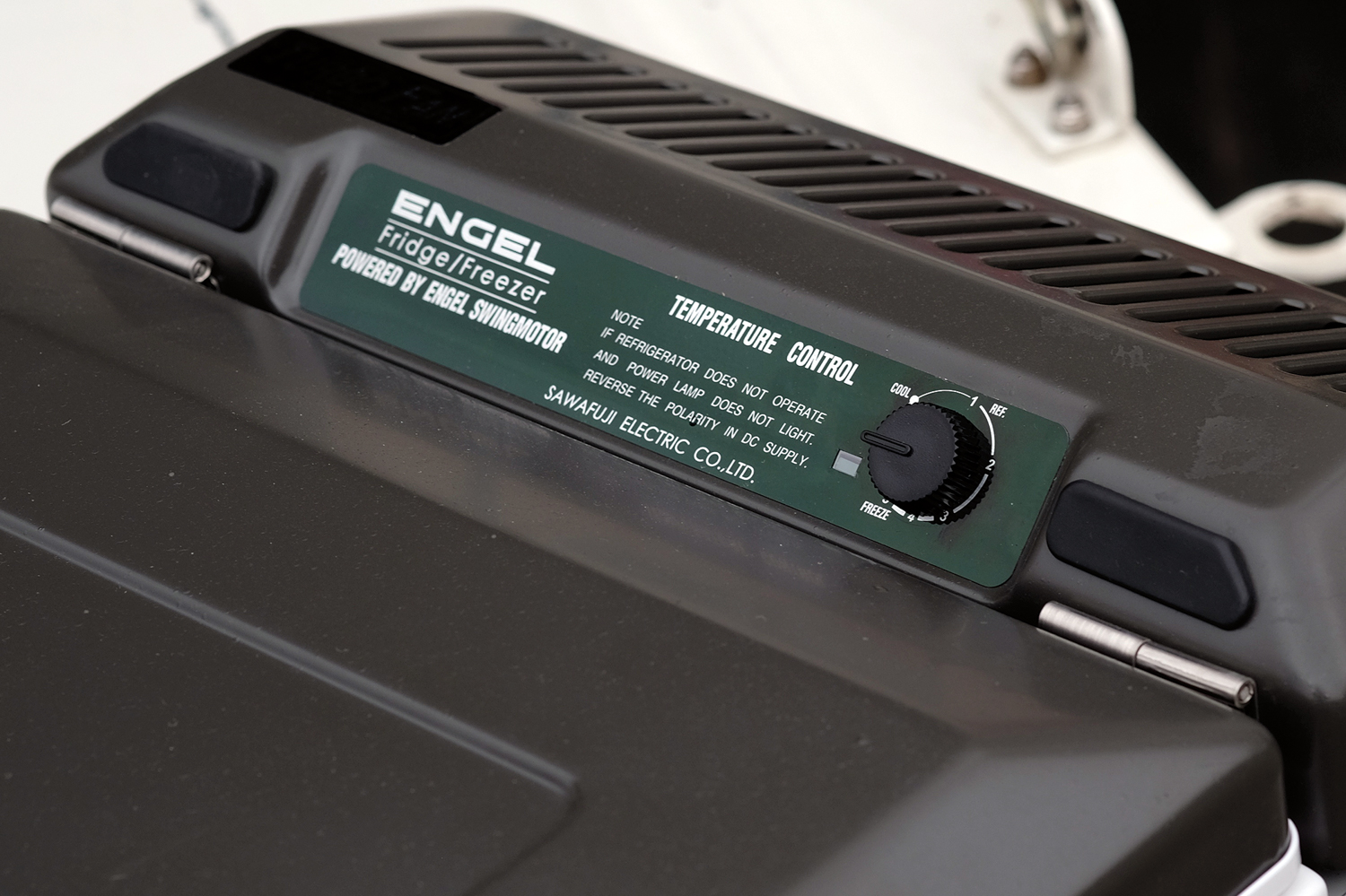

In contrast to the latest crop of portable refrigerators festooned with high-tech bells and whistles, the 45- liter Engel MT45F seems almost antiquated. In place of a multi-faceted control panel, it has a humble dial with vague settings ranging from off to freeze. There are no low-voltage protections and it lacks basics like an internal light or temperature gauge. With a dearth of features, some might ask why it is still relevant and worthy of inclusion in this test.
This is its fourth appearance in Overland Journal. The MT45F earned a spot here based on one attribute alone: reliability. Based in Australia, Engel has sold more than three million portable refrigerators over the course of a half century, and the unassuming MT45F has gone virtually unchanged that entire time. Stories abound of owners leaving their Engel units running for years, even decades, lending it a legendary reputation.
With an all-metal construction, the MT45F represents the halcyon days of a pre-plastic age when things were made well and made to last. The only non-metal component of any significance is the control dial which could also be considered one of only three moving parts. The others are the fan and piston housed within the unit’s famous Sawafuji swing motor, a component known for its near infallible operation that also contributes to the unit’s efficiency. During our tests, the MT45F consumed a reasonable amount of power getting to our target temperature, but once there, sipped electricity at the most economical rate. This might be a necessary attribute considering our warm-up test showed the MT45F was perhaps not as well insulated as other units. As such, the compressor needs to run more consistently to maintain a desired temperature.
The only real knock against the Engel is the quirky user interface. Only with practice did we determine that somewhere between the 1 and 2 settings did the inside temperature hover around our ideal 40°F mark. To best manage the thermal settings, it would be helpful to use one of the many available wireless temperature displays. Another welcome benefit of the Engel is the efficient use of space. With the second-best internal volume to footprint ratio, the MT45 will likely fit in tight confines where others will not. Those buyers easily won over by proven reliability and burly construction might overlook the unit’s paucity of features. Made in Taiwan, limited 2-year warranty.

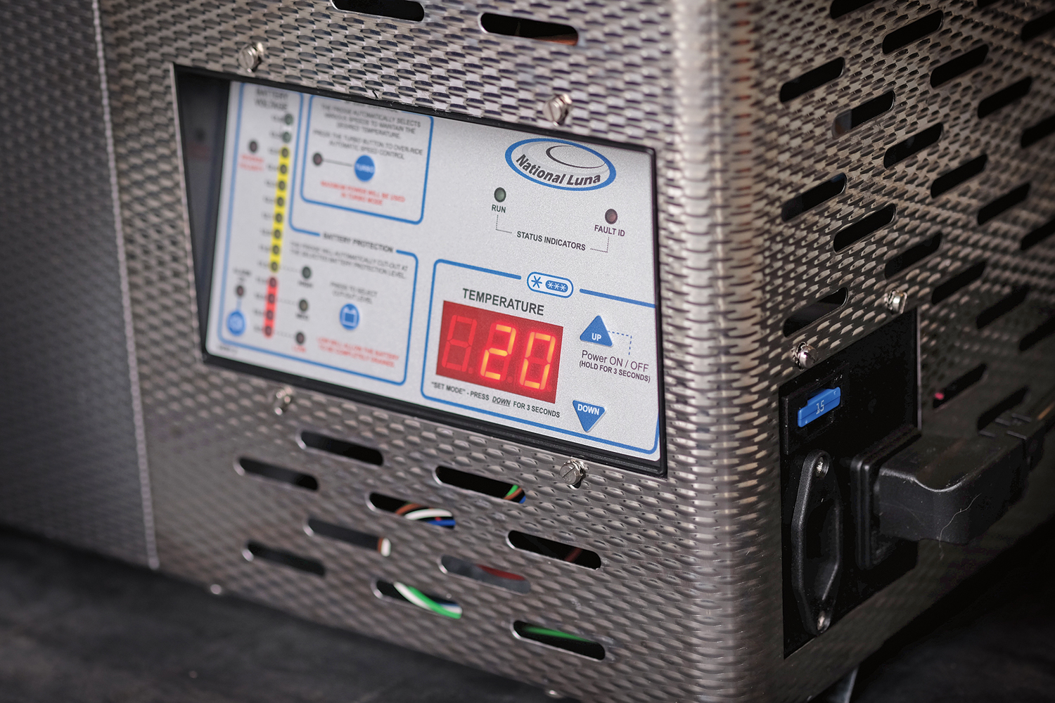

With their extensive catalog of products, selecting a particular National Luna sample to evaluate was surprisingly nuanced. Their 40-liter fridge with thick 60- millimeter walls would have likely bested every other contender in our performance tests. The Weekender 52, with slightly thinner 45-millimeter walls, is most similar to the others in our roundup with a main refrigerated compartment and a smaller shelf above the compressor. Also meeting our size requirements is the Weekender 50 Twin. Its unique design directs maximum cooling power to the small 10-liter freezer box. Unsure of which to test, we elected to include both the 50 and 52 Weekenders.
Every sample on our list, including the Weekender 52 is billed as a fridge/freezer, meaning the main bin can cool below freezing with the smaller crisper left slightly warmer. The 50-liter fridge and freezer is the opposite. When the temperature is lowered to the freezing point, the main compartment is approximately 10°F warmer than the smaller freezer box. In our tests this became a significant detail, muddying our data collecting waters. With our warm cans placed in the Twin, it required far more cooldown time than it did in the single compartment fridge. In the end, the sole purpose of this exercise is to help buyers suss out the product which best suits their needs. Simply put, if you don’t have a need to store frozen foods, the performance advantage would be with the single compartment Weekender 52.
Beyond those rather significant differences, the two are nearly identical. Both are made of stainless steel, have low-voltage cutoff protections, a digital temperature display, interior stacking storage baskets, an internal light, and a hinge system that permits front or side opening configurations. Although the control panel is placed low on the side, perhaps not the most ideal location, the power plugs are appropriately positioned at the back of the unit.
There is no denying National Luna products are built to a standard of quality second to none, and failures are virtually unheard of. Every component is made of superior materials and no minor detail of its construction has been overlooked. After multiple rounds of careful tests spanning 10 years, our team had a tough time awarding our coveted Editor’s Choice Award to anything else. Within that decision, we deliberately try to not make price a factor and despite the lofty sum either Weekender fetches, it is our collective opinion the cost is justified by the performance, features, quality, and legendary reliability. Made in South Africa, limited 1-year warranty.

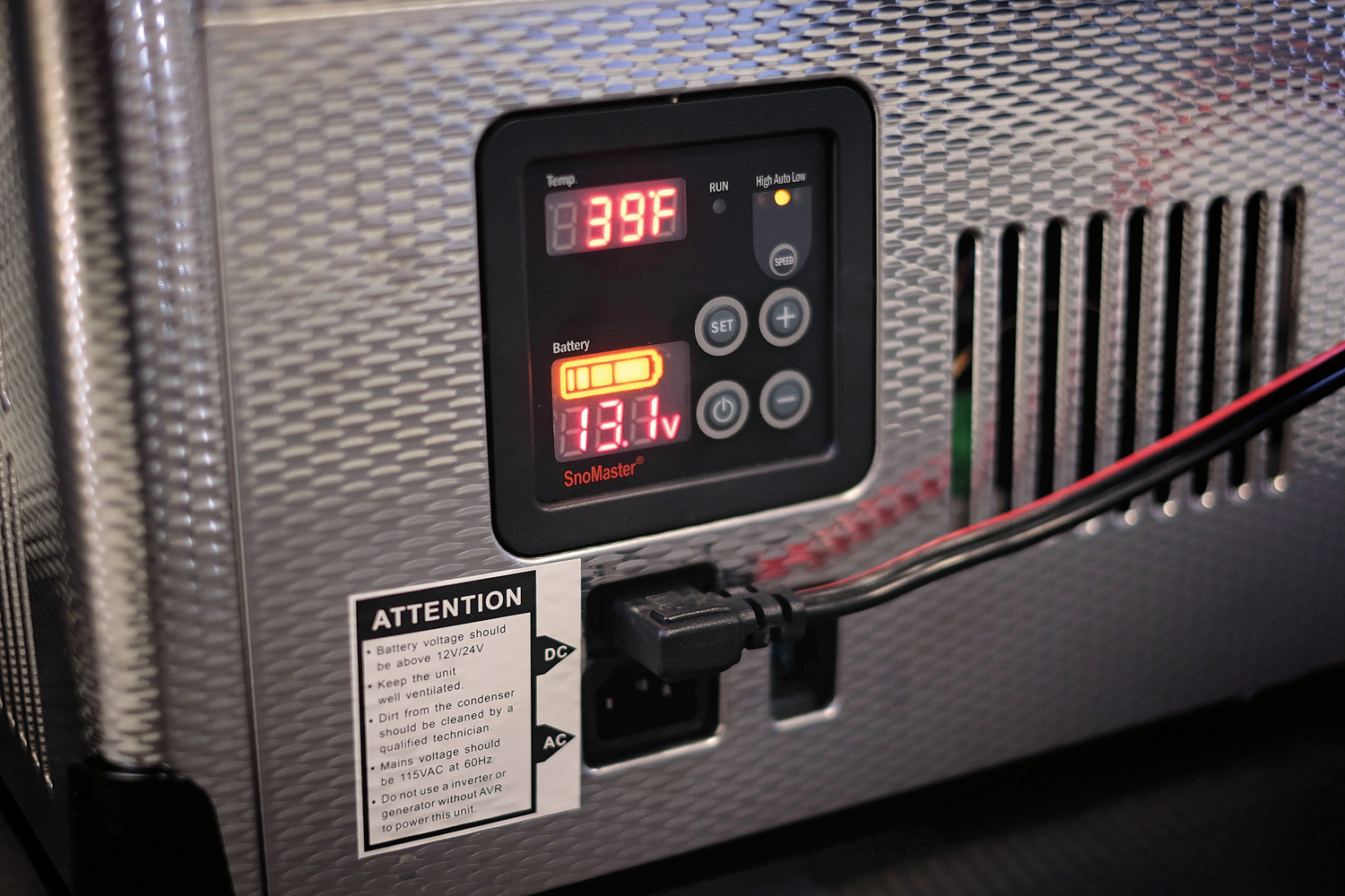

Another newcomer in this test with a decidedly similar design to the National Luna is the 42-liter SnoMaster Traveler. Like its fellow South African counterpart, this unit is made of stainless steel with highly insulated walls and has several features shared with the more expensive Weekender 50 Twin and 52 single-compartment units. A near clone of the National Luna fridges, there are a few notable differences, some for the better, a few for the worse.
During our cooldown test, the SnoMaster was only bested by the Indel B and 52L National Luna, all of them far superior to the others in that regard. The Traveler also had a respectable warm-up score, surprisingly average though given the generous thickness of the walls. The compressor used in the SnoMaster is made in-house and according to their U.S. distributor is similar to the popular Danfoss unit used in all but the Engel fridge. We did notice slightly more energy draw required to attain our ideal low temperature and while it isn’t a power hog, it did require a tad more juice to maintain the target. During that phase, the compressor cycled on and off with increased frequency compared to some.
Although placed low on the front of the unit, the control panel is easy to read and has large tactile buttons. The low voltage protections are accompanied by a battery charge indicator to help manage reserve power levels. The internal temperature readout was the most accurate of the group and was quick to respond to incremental adjustments. Inside, you’ll find a light, metal basket, and large crisper compartment over the compressor with its own small basket. On the exterior, two metal handles offer strong lash points, but not the most comfortable carry since they’re quite small. The front opening lid cannot be reconfigured with side hinges, but it is removable and connected with heavy-duty hardware.
As much as we liked the placement of the control panel at the front of the unit, we wished the power plugs were located at the back. The orientation of the plug itself is also a bit odd as it seems to be upside down, wrapping the cord the long way around the fridge. It’s a minor nitpick considering the quality of construction, excellent performance, and reasonable asking price. The SnoMaster also comes with a hard-mounted bottle opener and solar-charged wireless remote controller. Made in China, limited 5-year warranty.
