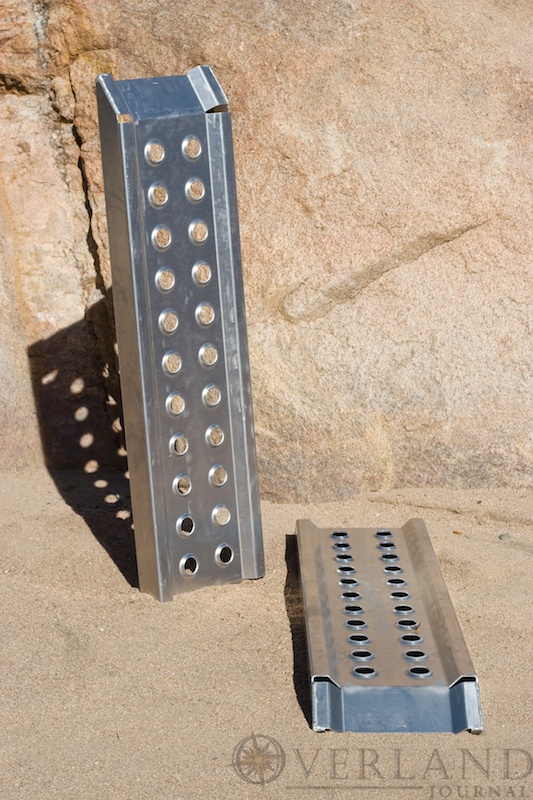

The Mantec Sand Tracks look the part, and garnered the most attention and desire from our group of testers. With classic PSP looks, these ladders would be right at home on the side of a Safety Devices roof rack, bolted to the top of a Sand-Glow-painted Land Rover. However, there is no doubt that Camel Trophy selected the PAP for function well before form, which was proven in our tests. The units are the longest of the group at a full five feet. They also store nearly flat, and would make ideal flooring for a roof rack. They will be less effective in wet or icy conditions, as the perforations only face towards the terrain surface, with nothing but a smooth aluminum surface on top to provide tire traction.
Soft ground
The Mantec sand ladder had a distinct advantage in sand, being the longest and widest unit in the test. It was easy for the front tires to climb and then maintain enough momentum for the rear tires to grab and continue pulling forward.
Bridging and ramping
We approached the bridging test with some trepidation, hoping that the weight of the Land Rover would not bend the well-loved units in half. As with the other ladders not intended for bridging, we doubled-up the Mantec, and gingerly rolled the Land Rover to the center of the 32-inch span. It only flexed 1.75 inches, impressing the entire test team. These units are not warranted for bridging, but worked beyond our expectations in the test. mantec.co.uk; available from britishpacific.com, 800-554-4135

For the Editor’s Choice, I selected the Mantec Sand Tracks, primarily because they do everything well, including a second-place finish in the sand climbs and a surprisingly effective result in the bridging test. The units are also in the middle of the pack on weight, yet have the greatest surface area and can be easily mounted to the flooring of a roof rack. The Mantec Bridging Ladder was clearly the best overall performer, but not by a wide margin, and comes at considerable expense in both cost and weight/bulk.
